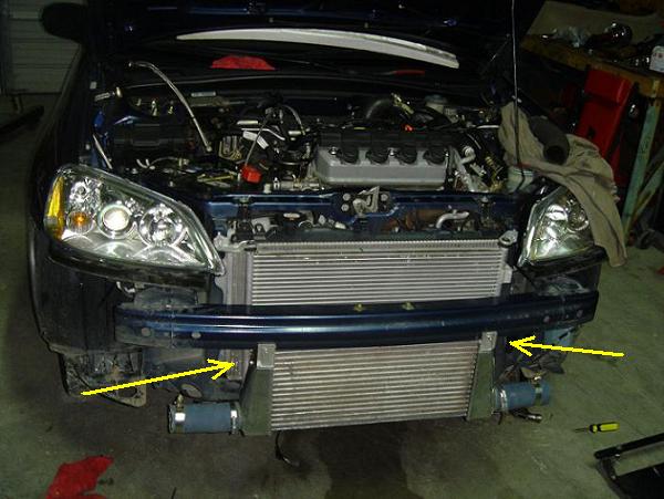

Try to do what i did. My intercooler is larger than TSI's so i dunno how difficult it would be but:
I tig welded two tabs, one on each endtank, and then bolted it to the front impact brace. here's a pic \/\/\/

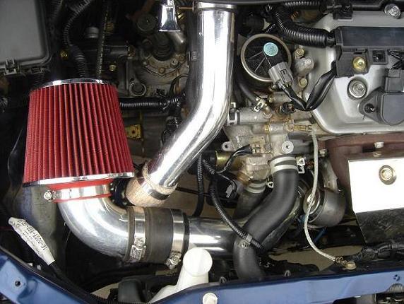

Originally Posted by Chris3k2
what kind of intake w/filter are you talking bout?? U can use a SRI with turbos or something. I'm sorry i've never gotten that part about turbo's where people have the air filters on them. I understand what they are for but just not for what they used or how it can be put on there. Did that make sense? but i am basically asking can u use SRI or CAI with turbo?? Please don't flame me for that question thanks.
As i'm sure you know, when boosted, your intake is relocated from the throttle to the compressor. All sri's and cai's are designed and bent to work from the throttle body. All you have to do is take an SRI or CAI and cut it into pieces you can use and connect them using rubber couplings. Here's the intake that comes with the TSI kit as on 2K1Civic17"Gabe's car (just a rubber hose and intake filter):
And here's what a AEM SRI looks modified to fit on my kit:
And here's a better pic \/\/\/ (Help any?)

/\/\ It's still a pain to work with such a tight spot, so it's realy no different, but not only does it look great but it really helps you spool faster and makes the compressor ALOT louder

like this kit doesnt spool fast enough, lol. the second Im on it, it spooled. I got a CAI that I can modify for this, I checked it out last night, and will probably be hacking it up this week, maybe not though cuz I got kids this week.
What kind of settings are you running BTW. Mine are set at 30 for boost. and anything less was lean they said. This was with only a couple pulls, but said I was at a 14:1 ratio when set around 0=10, 1=12, 2=14, 3=16, etc.
They set it at 30 and said its correct now, they could only get a couple pulls with my clutch, so they'll do them all proper in a couple weeks, they didnt charge for this one.
I am hating the TSI unit though. It is still resetting on me. Where did you ground the electronics for the TSI unit? I reqired everthing last night, found a few F'ups, fixed it all, not it resets on me still. I found a ground that worked once, than it stopped working all of a sudden and reset again. So maybe I need a "special" lol ground spot thats magical in my car or something. I spent hours and hours and hours trying to fix this stupid little piece of sh** unit that TSI calls a fuel controller. I really love TSI, but HATE their crappy unit.
