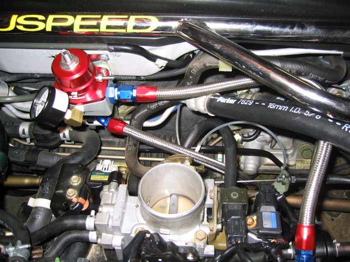

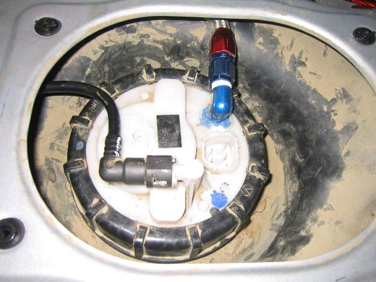

Well guys, Jeff from Streetlevelperformance and i finally got together to complete and install out Return Conversion...here is a couple pics....more to come

The conversion kits will be ready to go soon. As Wes stated, everything went very well with the install. We took pictures every step of the way and plan on offering extremely detailed instructions with the kit.
Pricing will be dependent on the fuel lines you choose. The base kit will include standard fuel lines and the upgraded kit will include braided lines. The lines will be precut to exact measurements and will come with all fittings in place. All you'll have to do is screw them on and tighten them down.
It was mentioned above that this can be done for $350-$400. That was probably a labor quote and not an actual parts quote. We are including the best parts money can buy in these kits. We are not going to sell you carquest fuel pumps that burn out over time. Here's a list of the brand names that will be included:
Walbro
Aeromotive (boost referencing)
Earls
B&M
You also have to remember that we are taking ALL of the guess work out of this for you. We are making it as much of a bolt-on as we possibly can. We'll release more information very soon as we are monitoring the kit over the next week or two.

got any pics of the fuel rail in the conversion?
Wes posted some previously. It showed the modified rail with the weld bung that the kit will include.
