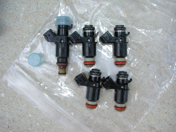

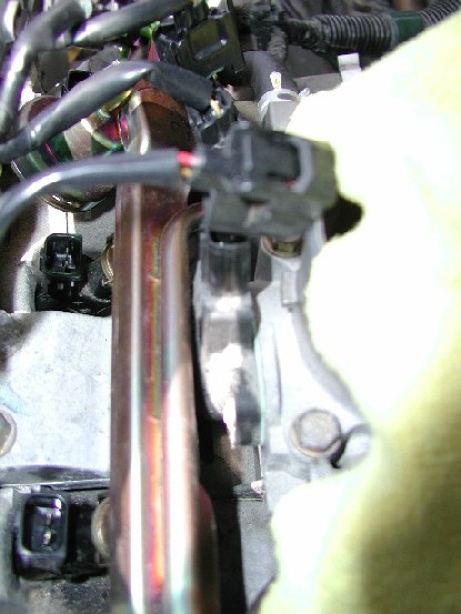

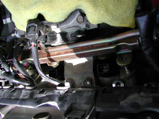

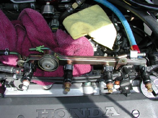

Well, everyone has been on my about the RSX injectors - well I just attempted to install them this morning....They FIT! See the following photos:
They are a direct replacement. The only modification that is necessary is the mounting studs on the intake manifold spacer plate.......

so... u need to just extend the tabs on the fuel rail so it can bolt up?..

Well - I didn't actually start the car with them in yet - because I want to wait until my turbo is in so that I can limp it to the tuner (titan motorsports) and have them tune it for me....don't want to risk blowing anything for the moment. I put the old ones back in for now....just wanted to see if they would even fit or if there were going to be clearance issues.

Yes, it fits as well....Just like stock, only a larger injector

To clarify - I didn't have to splice anything - the RSX clips are exactly the same as the civic clips....

I don't believe it would. It MAY work - however there are two things to consider.
1. The injector spacing for the K20 may be different than the D17, since it is a larger motor.
2. The AEM rail I saw over at the clubrsx forums still had the pulsation dampener in the center (ala the RSX-S style - the RSX has it mounted on the END).
So - the stock RSX (non S) rail MAY work if:
- There are no clearance issues since it may be a larger rail
and
- If the injector spacing is identical to that of the D17.
