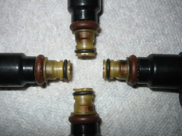

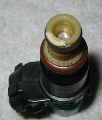

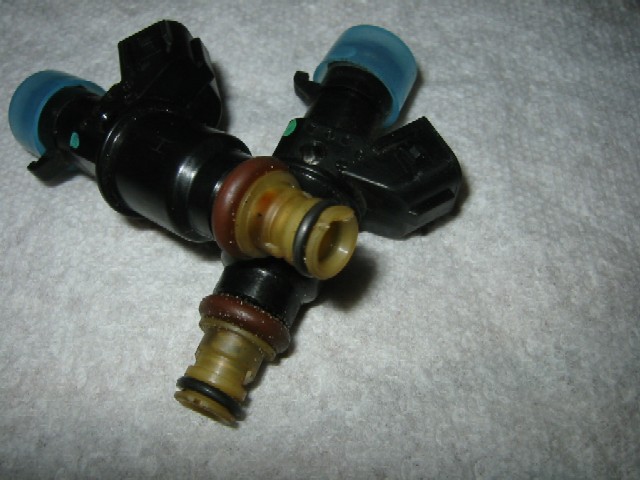

I paid $75 for these used RSX injectors, and when I get them, the o-rings have sand on them, and one of the ends where the fuel sprays out is cracked, about to fall off!
Can I still use them, if I clean them & snap off this broken piece?

Good place to get injectors cleaned & flow tested:
http://www.cruzinperformance.com/
Rich is a honest and nice guy! Very professional and highly recommend.

Taht would be fine, but did you see the cracked piece on the end of one of em? I am wondering if that might mess my stuff up?

I am not sure. Call Rich from there. He'll help you!

Installed RSX Injectors - Replace Stud with Bolt
I installed my RSX Injectors today;
Had to replace the fual rail stud with a bolt instead, I used a Metric (I am Canadian!) bolt 30mm, M6x10, and 2 washers because the RSX injectors are about 0.75In longer that the Stock Civic ones.
It was easy, and I set my E-manage at 240 Old & 340 New Injectors, what did other people use. This worked great, but I didn't try any other settings.
Some Pics:
Done & Done.
