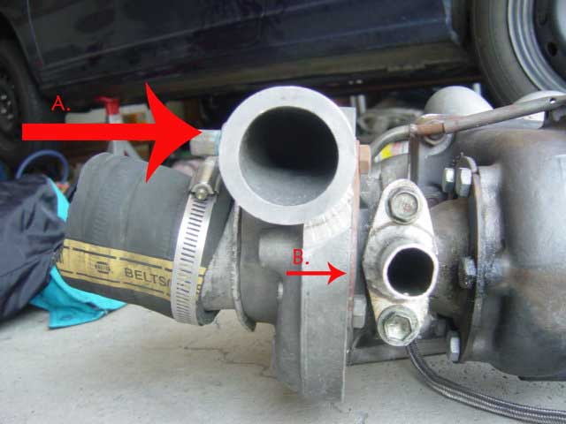

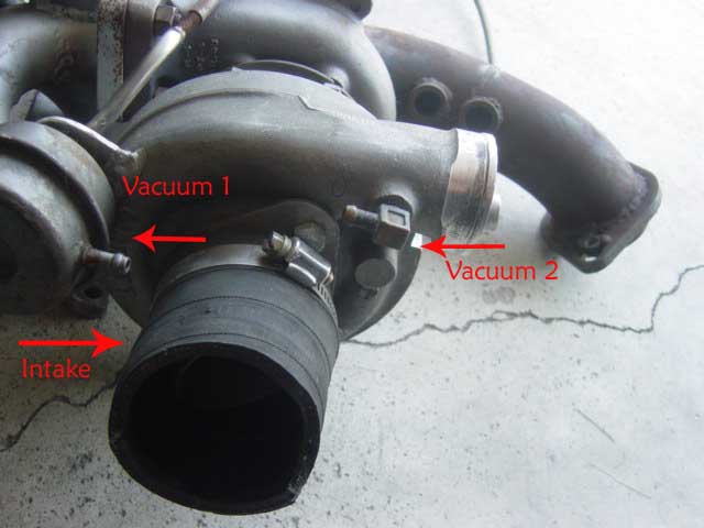

Ok, this is my turbo that I'm putting on...
I have provided pictures with labels for you...
My questions:
*Where does model A go to?
*Where does model B go to?
*Where do the Vacuum lines 1 and 2 go to?
I know that the vacuum lines go up to the intake manifold somewhere, but I'm not sure which one goes where and to where, exactly.
Please help me out...I want to be boosting asap!!

im pretty sure vacumm 1 goes to Vacumm 2. Correct me if im wrong. Also the Coupling that is on the turbo piping runs to 1 side of the intercooler. B is where your Oil return goes to. Not sure what you are pointing at at A...

A goes to the intercooler...

This is the SF kit....
and no...A is pointing to that huge hole....vaccuum 2 is pointing to that little nippled valve coming out from the turbo..

vaccum A connects to vaccum B
A. runs to the bottom inlet on the FMIC and B. is ur oil return line that connects to the oil pan fitting.

No offense but what do you know about turbo's that you didn't know what the hole on the compressor side of the turbo goes to?

I know enough, I was just making sure it wasn't any different for an air to water intercooler. kthx.
