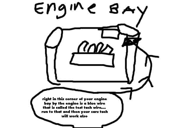

directions
here

Old Mar 16, 2004
Got Boost???'s Avatar
Posts: 5,268
From: In a Box
Rep Power: 344
ok there should be 4 wires
1) ground
2) power
3) revs
4) illumination
Ground Wire - The ground wire should be close to the tach itself, if you remove the panels under the steering column you'll see a 12mm bolt just sitting there. Attach the wire to this and use it as your ground.
Power - ***WARNING is you dont disconnect your battery you must wrap the end of this wire ( the end that will be fed through the fire wall) in electrical tape because any contact with metal will cause your fuse to blow out. So either disconnect the battery or wrap the exposed end in electrical tape.***
Open up your under the hood fuse box and locate the HORN STOP fuse remove the fuse and place the end of the wire under it and reinsert it.
Revs - This is the blue wire that was talked about earlier. Its over by the battery in a bundle, just pop off the cap and connect
Illumination - Open up your under the hood fuse box and remove the right headlight fuse, place the end of the wire under the fuse and reinsert the fuse.
Now that have all your lines connected you need to feed them through the firewall. If you look down past the steering column and to the passengers side you'll see a sorta of neon blue line comming through the firewall. This is the point thats easiest to feed the wires through.

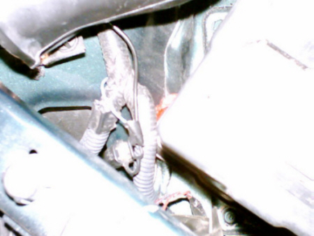

Old Mar 17, 2004
DistinctiveBP's Avatar
Shows No Remorse
Posts: 1,547
DistinctiveBP is an unknown quantity at this point
pic 1

Old Mar 17, 2004
detroitbeats's Avatar
Posts: 158
From: Detroit Mich
detroitbeats is an unknown quantity at this point
pic 2
DistinctiveBP has attached this image:
(thats all i see i dont see any pic)

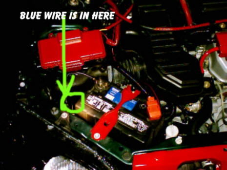

Old Mar 17, 2004
Shows No Remorse
Posts: 1,547
here is a close up. its the one with the lil black plastic piece attached to the end of it

Old Mar 18, 2004
Posts: 158
From: Detroit Mich
yes
so that the top corner of the engine bay near on the drivers side?

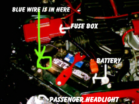

Old Mar 18, 2004
Shows No Remorse
Posts: 1,547
no if your looking at your engine bay. look right next to the battery.
Old Mar 18, 2004
Posts: 158
From: Detroit Mich
ok thanks so much i cant wait to hook it up

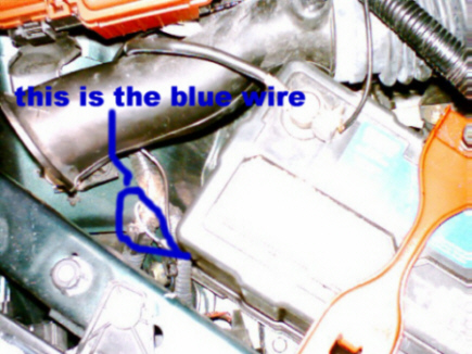

Old Mar 18, 2004
BREEZE's Avatar
Yeah, i drive an EP
Posts: 1,226
From: OH-DIME
BREEZE is an unknown quantity at this point
my pic was right on
