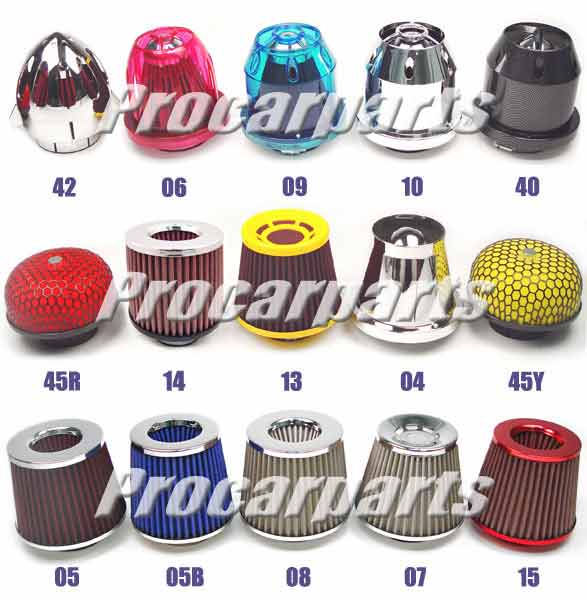

ok sooo what if u got a filter like say numbers 42 06 09 10 40 and 04 ?
i mean i duno where urs sits but if i did that id be more then fine...
not to mention your air filter sucks from in front of the tranny if im not mistaken.. mine points the other way.. SF kit should be fine with it imo.
