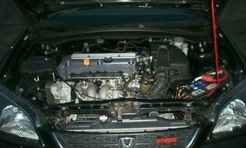

LiLaSiiAn8's Avatar
Posts: 2,404
From: san gabriel, california, usa
uh huh
Name:	picture 020_edited.jpg

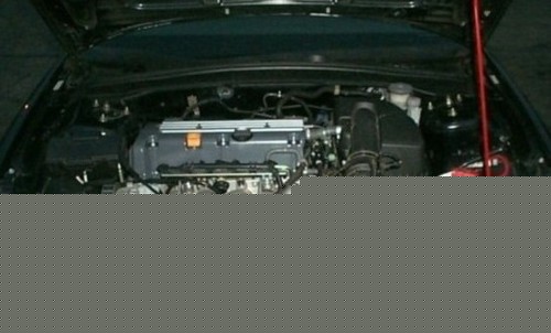

Old Sep 23, 2003
LiLaSiiAn8's Avatar
Posts: 2,404
gRrrR
Old Sep 23, 2003

Whos car is that

looks like that fits right!!
with the K20A don't you need a U.S. wiring harness since the Japan spec one will locate the ecu on the drivers side?

what is that a K20A3 motor? I know that motor is from a civic hatch, but i dont know if the CTR has that power steering setup or not. And i cant seem to find a picture at the moment, so i will assume that its a K20A3 motor. Whos car is that though?
Old Sep 24, 2003

Em2Guy is an unknown quantity at this point
it dont look like he has power steering
clean job though!
