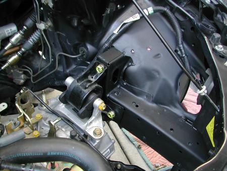

really? famous? cool. well nobottlenobrain i went to this guys house and took some pics

can I see the pics of the whole engine bay, not just the mounts?

i was just showin the mounts .. cant tell if its a civic?
Thats not where the mount is on the 7th gen civic the battery would be right there.

well good for him...but why did he remove all of the brake hardlines? With the money he saved on not buyin the HASport motor mounts, hes gonna have to spend on making new brake hardlines.

brake hardlines wtf? someone school this guy........oh wait u talkin abs?well the car never had it Lx

SI?? nope that's not a SI ive seen the swap in person and drivien the car. the owner of the car is a good friend of mine. and yes stock mounts will work no need to spend $$$$ on HASport mounts. but they would be nice
