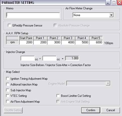

Originally posted by Catalyst
The SAFC II starts at 1000 rpm and goes in 200 rpm intervals. The Emanage starts at 500 rpm and also has pre-programmed fuel maps for different displacements with different injectors (if im not mistaken)
E-manage owns the SAFC.... and the SAFC is more expensive. As far as pre-programmed:
Even if you don't touch a fuel map at all, and just add larger injectors, it creates a factor and the whole fuel map gets adjusted automatically to compensate the change in pulsing and fuel.
I'll add some screenshots:

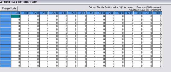

Airflow
