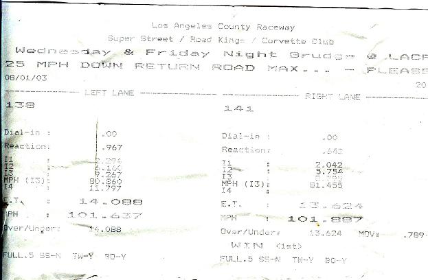

It is true. I ran an UNCORRECTED time of 13.6 @ 101.9 mph on 9 psi. I turned it up to 11 psi then did my burnout, and they kicked me off the track because i didnt have a helmet.
anyways, i am at the shop and i will post the timeslips when i get home tonight. I will tell you my times right now.
Reaction .642
I1: 2.042
I2: 5.754
I3: 8.795
MPH (I3) 81.455
E.T. 13.624
MPH: 101.98 MPH
remember, i am at 2900 ft in 90 degree weather.
The correction factors is ET * .97 MPH * 1.03
So..... corrected i ran a 13.215 @ 104.94 MPH
Our goal is to get the car into the 12's with the stock engine.
I was on some good tires, but on some real slicks, i would have had a 1.8 60/ft time.

it is the base kit with the alcohol injection
Here is my time slip
I am number 141

the other car was a twin turbo 300zx.
Yea, all we do is build honda stuff. We plan on making everything for the car. Pretty soon you will be able to buy a complete engine/turbo system from us and drop it into your car and go 11's.
I was launching at various RPM's. It spun the tires, so i would pulse the throttle to get it to hook. It worked out well for me.... 2.0 60'
