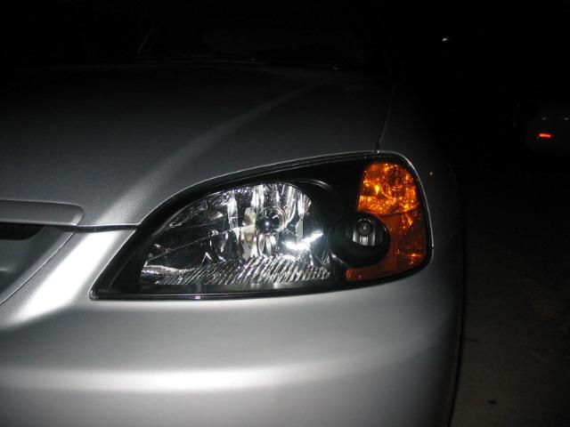

Weaponx12o's Avatar
Posts: 2,943
heres mine.. i left the amber piece in.

so u guys juss painted over the chrome? with what paint?
wouldn't it effect ur headlamps eventually if its heated and the paint smears? if its sum good free ****, i wanna get my lamps done =D. what kinda paint u guys used?

Weaponx12o's Avatar
Posts: 2,943
no the paint is not affected by the heat from the headlight. the "chrome" plastic part is seperate from the actual headlamp assembly. make sure you tape up the reflectors, so the light will still be visible.
i used duplicolor glossy black. it doesnt have to be a high heat paint. just make sure when you do it, you give it plenty of time to dry, or else the fumes from the paint will mess up the outer housing (cover).
