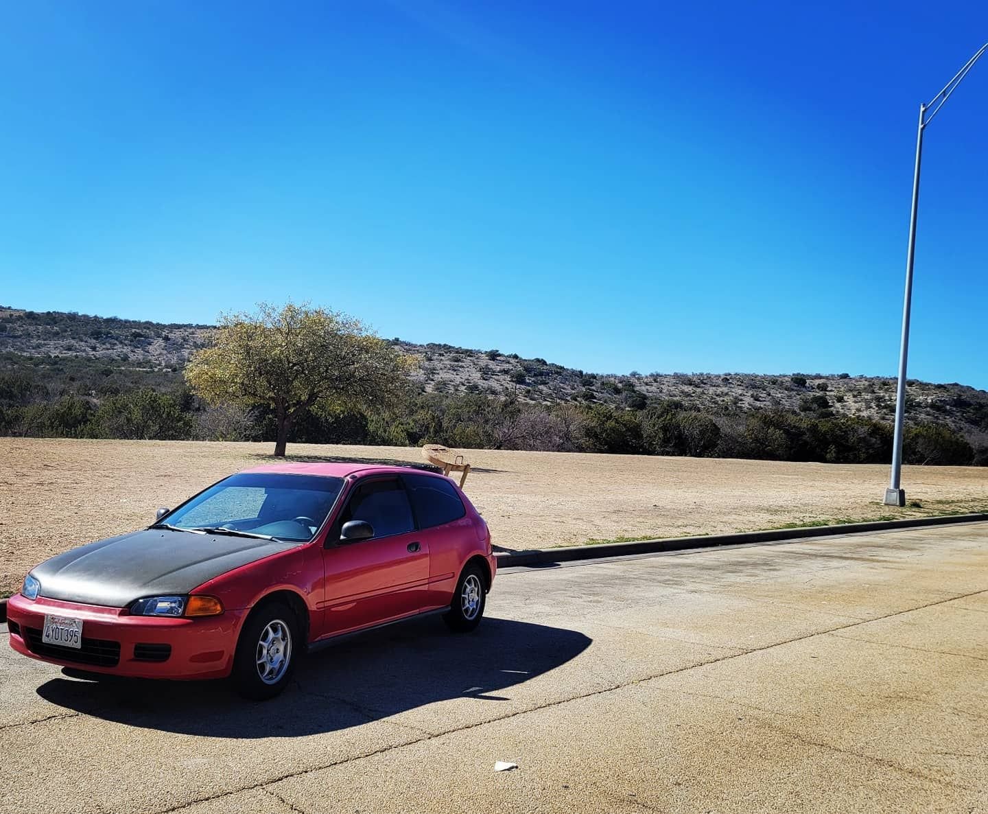

2/5/21 170k miles, brought in for alignment due to severe inside wear on the rear tires. Spec sheet shows everything was okay, so the wear was probably there beforehand. Sucks cuz the tires look almost new otherwise. Front tires look 90%.

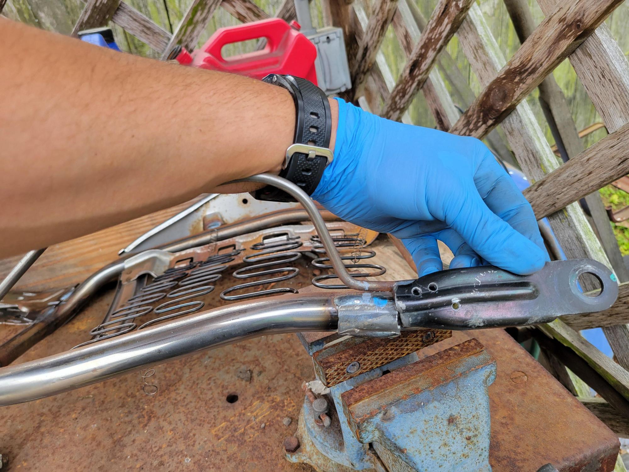

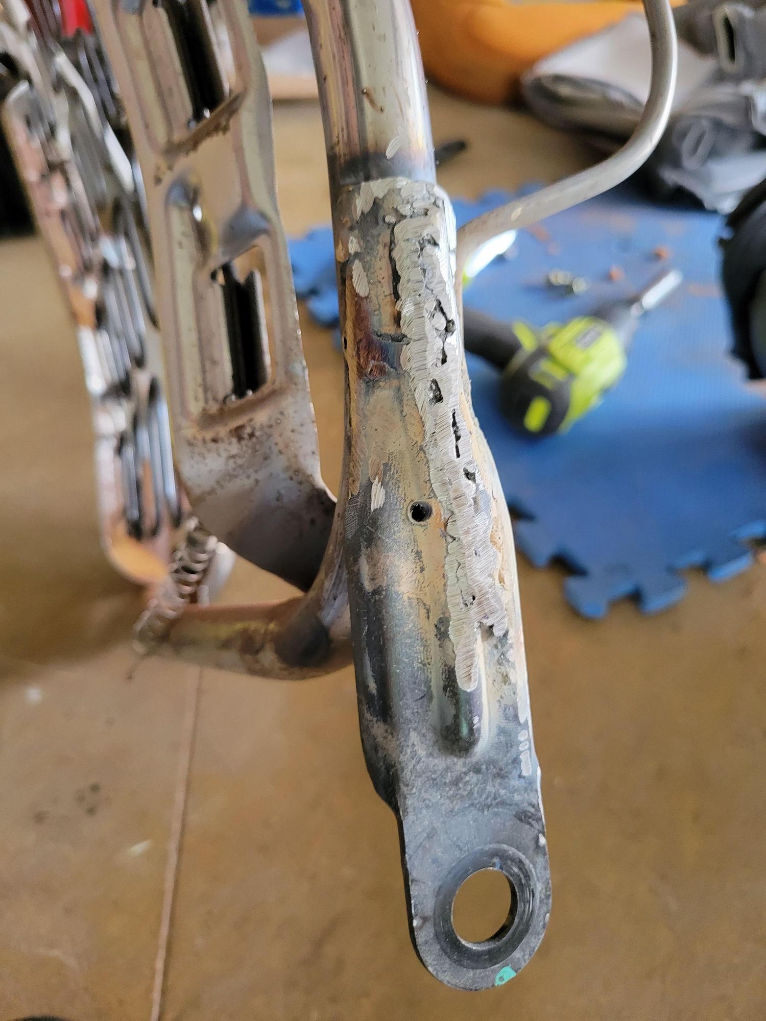

driver seat frame was cracked. removed back of seat and welded the bracket back on then welded a strip of steel along it for strength.
It's not a pretty weld but it'll do the job

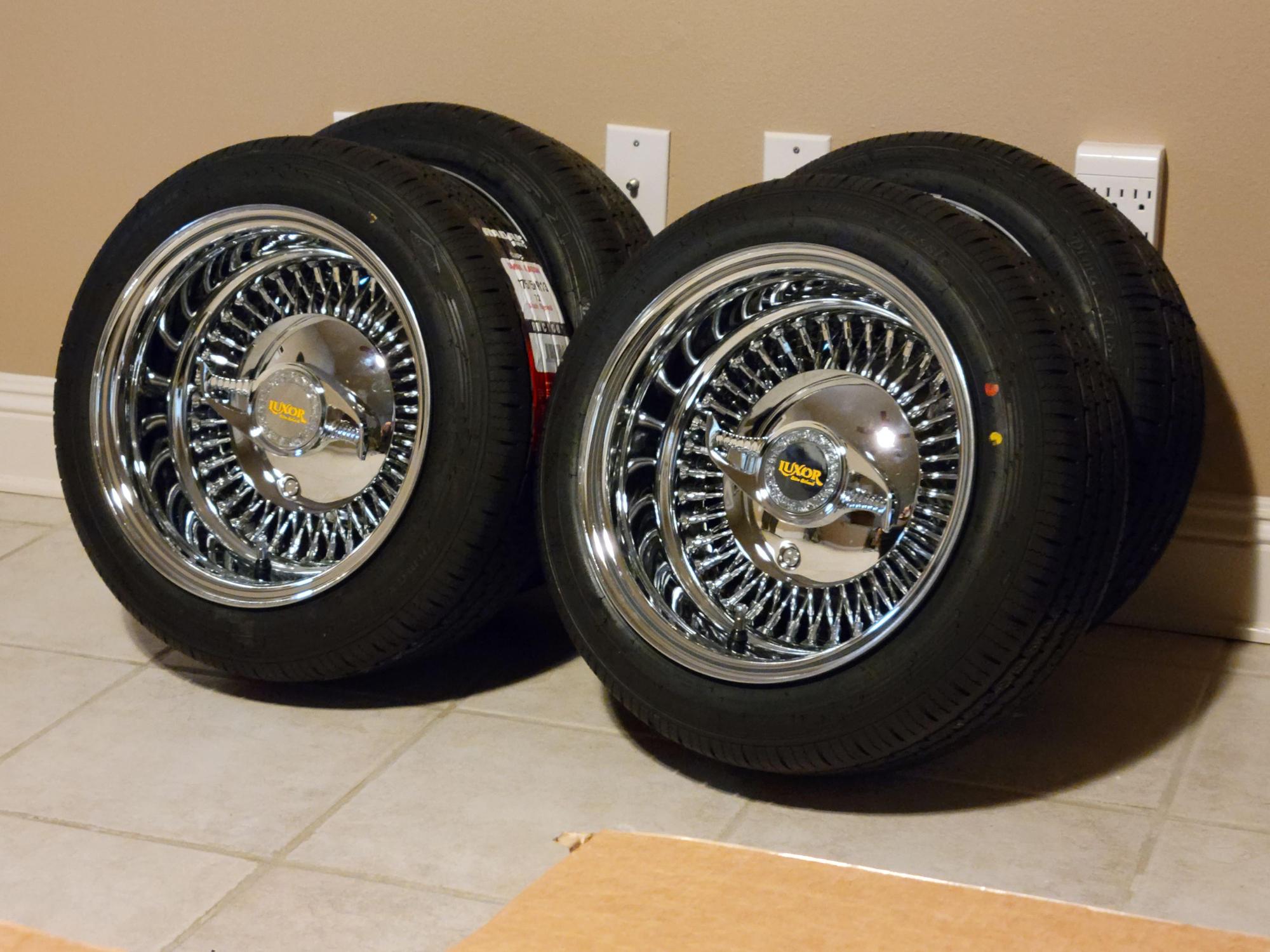

Ordered wheels today. Luxor 13x7 80 spoke reverse bolt on wheels with 2 bar spinners: https://luxorwirewheels.com/collecti...oth-cap-chrome
Tires will be 175/50r13, but I'll wait for the wheels to arrive.

Wheels arrived today. I'll do a test fit tomorrow.

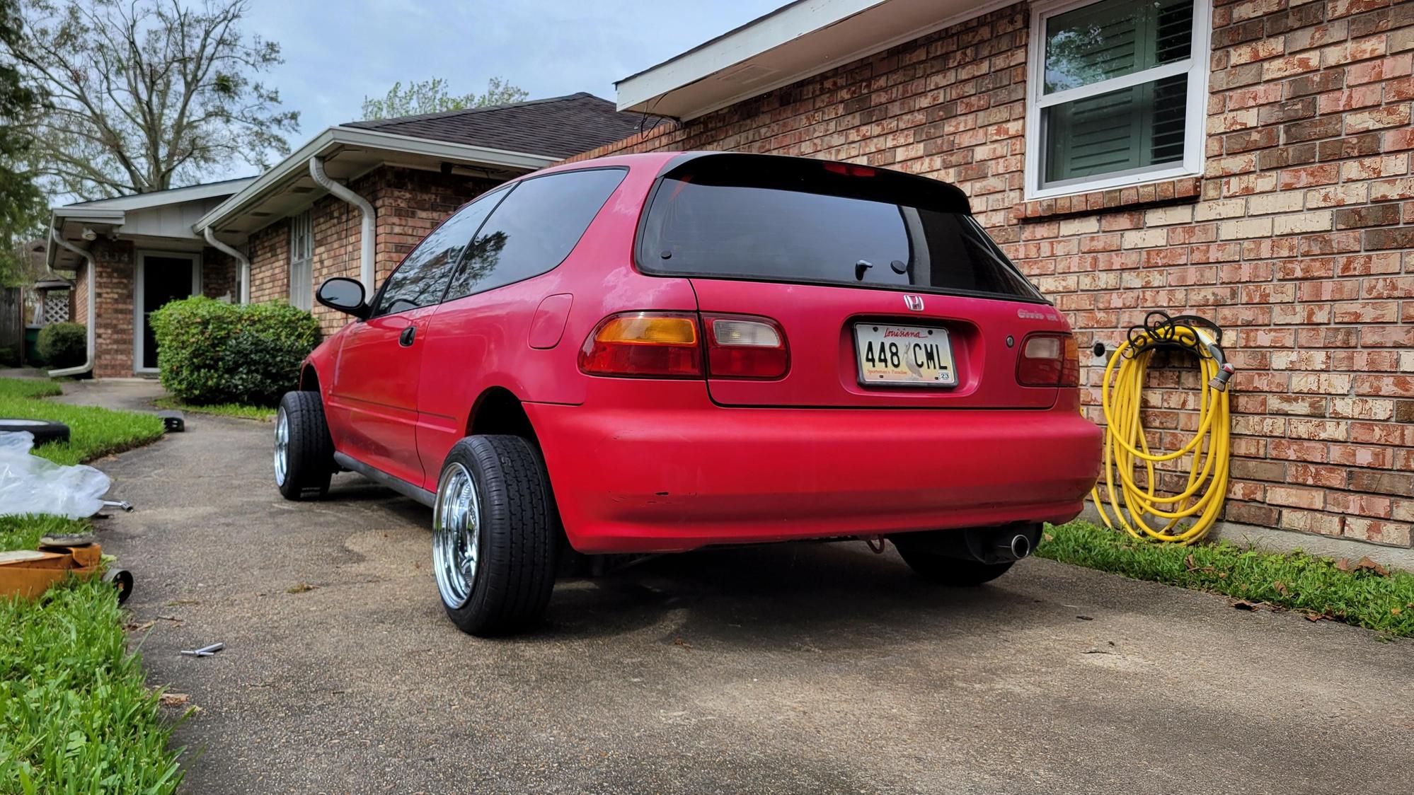

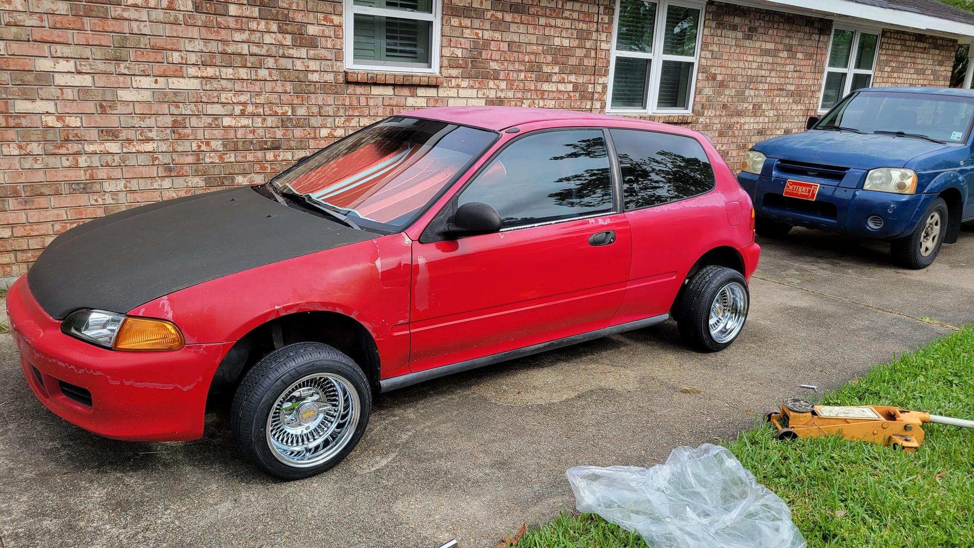

Test fit the new Luxor wire wheels today with my son. I think they stick out a little too much, maybe by an inch. I'll keep them however. While putting the OEM wheels back on, 2 lugs broke due to seizing, so that and a new suspension are next on the list.

it's a very specific niche, so I don't expect everyone to like it. I fell in love with the Civic hatchback in 1992 when I saw a 1991 Civic lowrider passing me on the road. I've been planning this project since then.
