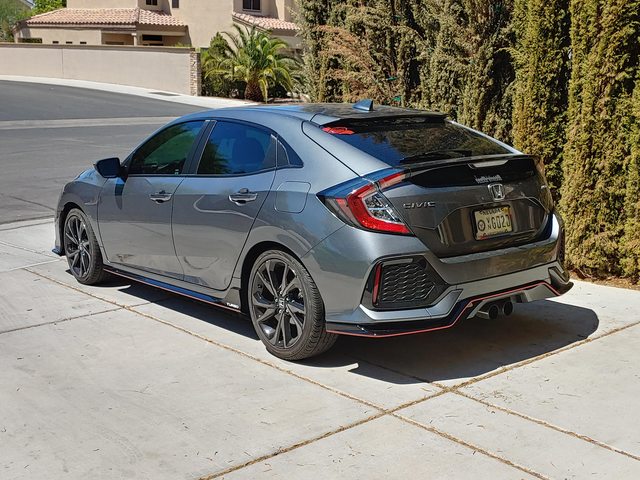

Figured I'd keep tabs on how I'm modding my 2018 Sport Hatchback, so here y'all go. lol
>>>CLICK HERE IF YOU WANT TO SKIP TO PART 2!<<<
2018 Civic Sport Hatchback
Engine: L15B7 1.5 Turbo (180hp running 91 octane)
Transmission: CVT with paddle shifters
Color: Polished Metal Metallic
Codename: Miyuki
November 11, 2017 - Game Start

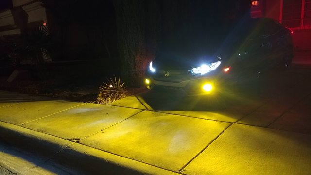

December 4, 2017 - HID install Parts installed: Morimoto Elite H11B HID kit (5500k bulbs, 35W ballasts) from TRS
Wasn't too wowed by the stock headlight output, so I went ahead and bought a Morimoto Elite H11B 5500k kit from The Retrofit Source. Nice and pure white, cutoff is like OEM halogens, much better light output. Dunno if this quite counts as a mod, since it's a bulb upgrade in the OEM projectors. Thank glob for TRS Black Friday sales. Nabbed the kit for $127 shipped

I also happened to get yellow LED fog light bulbs from Amazon for $20. Because JDM.

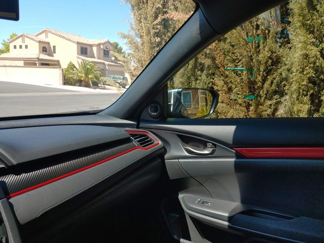

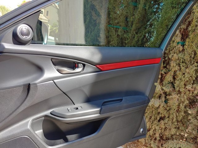

August 1st - A Wild Pinstripe Appears! Parts installed: ProStripe 1/4" red pinstriping tape (AutoZone)
Showed my buddy Matt @mdd1994 my interior wrap job. He suggested I start putting red on the outside. So I bought some red and put it on the outside. Added my own CTR-style pinstriping on my OEM ground effects.

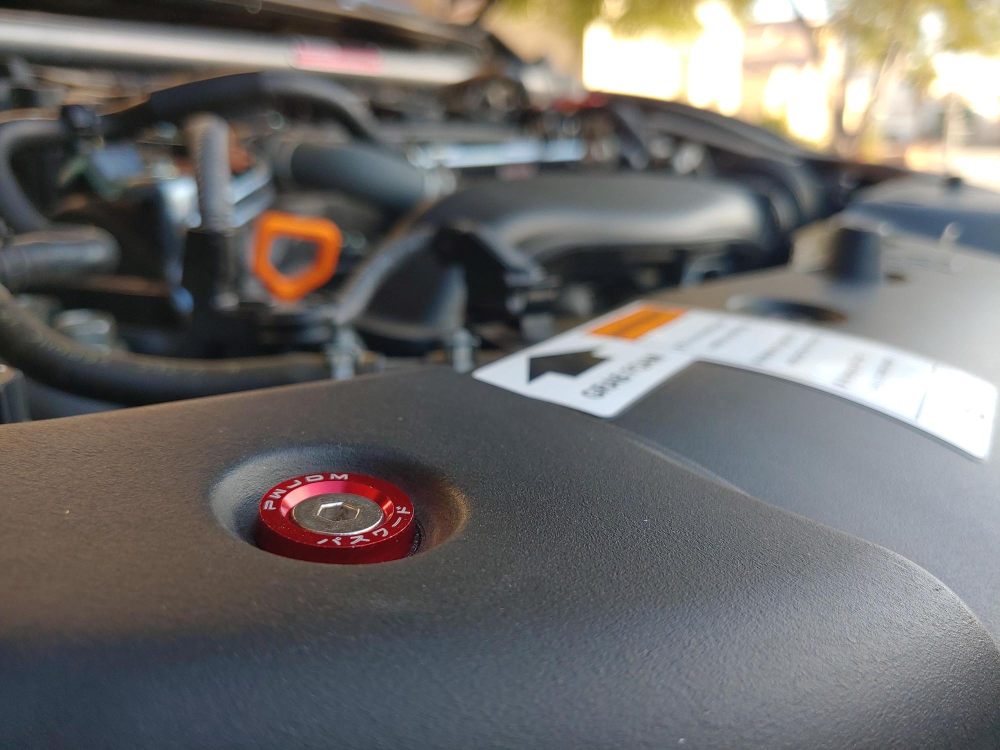

August 23, 2018 - Miyuki gets more bling Parts installed: Knockoff PasswordJDM fender washers from wish.com
Miyuki was yelling at me that I don't buy her shiny bling. So, of course, I bought her some shiny bling. A set of PasswordJDM fender washers. Ok, not really. They're knockoffs from wish.com. Let's see.. $17+shipping for 5 sets on their website? Or $2 shipped and wait a month for 10-sets of knockoff bling. I'll take my chances with the knockoff bling. They're non-structural bolts, and even the "important" bolt that secures one of the top tabs of the headlight, I can always upgrade the hardware for that. It was also bugging me that the engine side covers were fairly asymmetrical, as the passenger side had a hole which mounted nowhere (had to make that hole on my car's support beam) and the driver's side had a place, but no hole for one, so I made them both the same. Had a set of RivNuts in M6x1.0 from a while back, so I used those, too
August 25, 2019 - Updated bling, and more! Parts installed: painted hardware for knockoff PasswordJDM fender washers
Well... the knockoff PasswordJDM fender washers may look the part, but the bolts they came with are likely hot garbage and I decided to upgrade them to stainless steel bolts from the hardware store. But I couldn't just leave them all silver looking like that. Ruins the color scheme. So I painted them gold. They ended up being a "burnt bronze" kinda color because I coated them with VHT satin clear and baked them to cure the ceramic clear coat. I also changed out the hood mounting bolts on the hood hinge since I had 6 extra fender washers laying around. Those were tightened down by using a 4mm impact allen bit and a 1/4" socket and socket wrench, and only tightened down one at a time. It's secure, I promise you. LOOKIE!

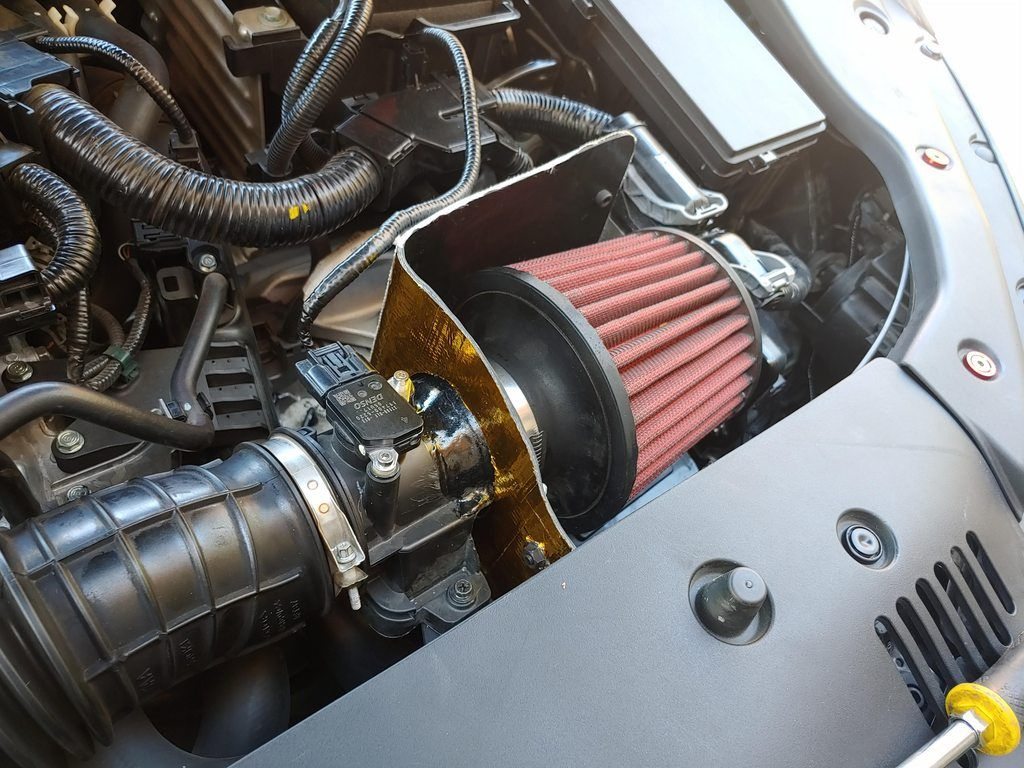

September 12, 2019 - What's cooler than being cool?! ICE COLD! ALRIGHT ALRIGHT ALRIGHT ALRIGHT ALRIGHT ALRIGHT ALRIGHT Parts installed: Custom RAM induction for DIY intake
Okay, maybe not ice cold, but a lot closer to ambient than before
Finished up the reason why I cut out the holes in the faux vent
Mounted an intake duct in the bumper. The stupid funnel thing was a TIGHT fit.
But, I got it sitting pretty behind the vent. It's kinda pushing up against the soft shroud next to the fog light, but it's posing no issues that I can see.
Inside the engine bay, I fabbed up a heat shield to perform 2 functions: 1) help radiate heat away from the intake filter and 2) serve as a mounting point for the intake funnel duct
The heat shield box itself. Its made of 2 layers of fiberglass cloth, and 2 extra layers of resin, with some black mica powder mixed into the resin to give it the color. The right (passenger) side and underside have heat barrier tape (roomie gave it to me bc he had extra) and since I only had enough for those 2 faces, the backside has a layer of adhesive-backed silver carbon fiber (dry) that I bought a LOOOOOOONNNNNGGG time ago and never got around to using it. In fact, I forgot what I originally bought it for. lol. I have some rubber edge guard on the way and I'm gonna put that on the edges to help prevent delamination of the layers of fiberglass/rolling of the tape edges
And pics of just the heat shield installed
And the whole shebang installed. 2 brackets made, one on the front side. I doubled up the mounting points for the MAF bracket and the heat shield bracket. On the backside, I used a factory intake mounting point. Both brackets were made from aluminum stock bought from Home Depot, painted in black BBQ grill paint.
from the backside of the heat shield, the duct going into the bottom of the box
and proof of function:
painter's tape stuck onto the radiator cover, doubled over so it didn't stick to the filter.
Leaf blower aimed right into the intake funnel in the bumper.
Sure, this mod was really because I was bored and felt like fabricating something. lol. BUUUTTT, it did help quite a bit. Check out my thread on IATs

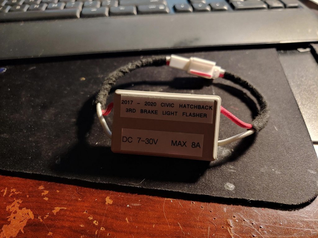

October 17, 2019 - Flashing. Lights. Parts installed: 3rd brake light flasher unit
More OEM+ modification, this time a 3rd brake light flasher. Got it for $40 shipped from a guy on CivicX that sourced all the parts. If you're interested in one, it fits all 10thgen hatches, but he's backordered until November. He's also sourcing parts for at least the sedan (not sure if the coupe uses the same connectors). I also used my label maker to put the labels on bc the original stickers were doodoo. But I digress.
There are 16 different configurations, and the one I have it on is flashing 5 times followed by a "breathing" effect. We'll see if this garners any unwanted attention from the boys in blue. lol.

Yeah, this'll pulse for more than 5 seconds. lol. Oh well, It's an easy fix if I get cited for it
OEM (just for comparison sake):
And with the flasher module installed:
and another angle. Realized idgaf if people know my license plate number. Do something.

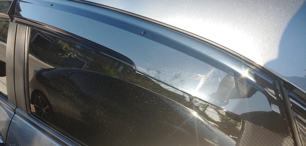

Mmm.. visory.. I got these visors from ProCivic.com. PRO Design MG-style (Mugen style, for the uninitiated). I was on the fence about getting window visors bc a) I was "eh" on the look of Honda accessory/style visors and b) didn't really feel like spending $300 on genuine Mugen ones. Also read so-so reviews on the $40 ebay mugen style ones. Then read better reviews on the OEM style procivic ones, but was still on the fence since, well, OEM style. THHEEEEENNN, randomly viewing their product page for the visors (since I kept going back and forth) and saw "MG style" ones for the hatch for $82 shipped. Realized I was gonna buy them at that point so I ordered 'em.
Pros:
  • They look good. Well crafted
  • Tint on them is a nice black tint, as opposed to some purple or green hued ones you may see out there.
  • Install was a breeze. Only took me like 15-20 minutes
Cons:
  • Install is only 3M tape, compared to OEM/OEM style/genuine Mugen which uses 2 in-channel clips and 3M tape. Took her out for a test drive on the freeway almost immediately after install to see how sturdy the install was. Got her up to 80 and tested it out with varying degrees of window level, and when I went to go fill my gas tank after all that driving, they showed no signs of budging.
  • Curvature on the fronts seemed off when I first did a dry fit. Laying the back end of the visor, the front was about an inch off target. Actually wasn't bad when it came to install, though. I laid down the top edge and let it "curl in" a little, then flattened it down. There didn't seem to be enough tension on it to make it want to spring off any time soon, nor did it look like it was forced on.
  • The length on the rears seems a hair short. There's about a 3/16" "gap" on the for and aft ends of the visor if I have it centered on the door. You can see that "gap" on the 2nd picture. It's only noticeable if you're looking for it.
  • They have some dumb looking metal badges on the aft end of the fronts. Notice they're not on mine, however. They're only attached with a mild adhesive and I was able to get them off with the aid of a plastic spudger (cell phone repair tool). Some rubbing alcohol and a bit of rubbing with my finger and it's like they were never there.
  • (July 2020 update) After a while with hot Vegas summers (excess of 120F/48C), the rears didn't seem to hold up well to the heat. Started to get some heat deformation in the very center of the rears which caused the lower lip to rattle against the window. ProCivic was good about getting me replacements though. I still might upgrade to the genuine Mugen ones down the line after that though.
For people wondering how secure these are just being mounted with 3M double sided tape, since it was chilly out, I used a heat gun to warm up the adhesive prior to installation. Almost immediately after installation, I took her for a test drive. Got her up to 80MPH (128KPH) with varying degrees of window level. None of them flew off, lost an adhesive edge or otherwise made me think I was gonna lose one in the future. I tugged on the driver's side one when I was filling up and that sucker ain't going anywhere unless I want it to.
