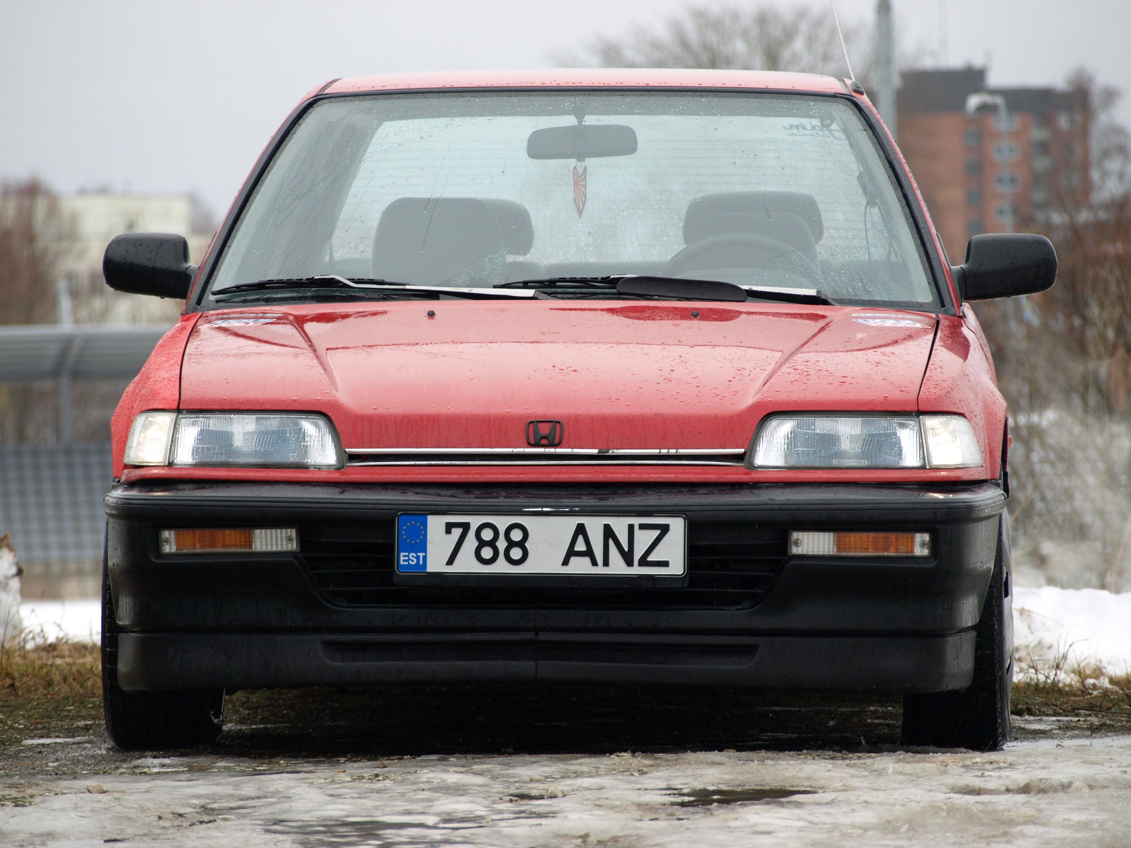

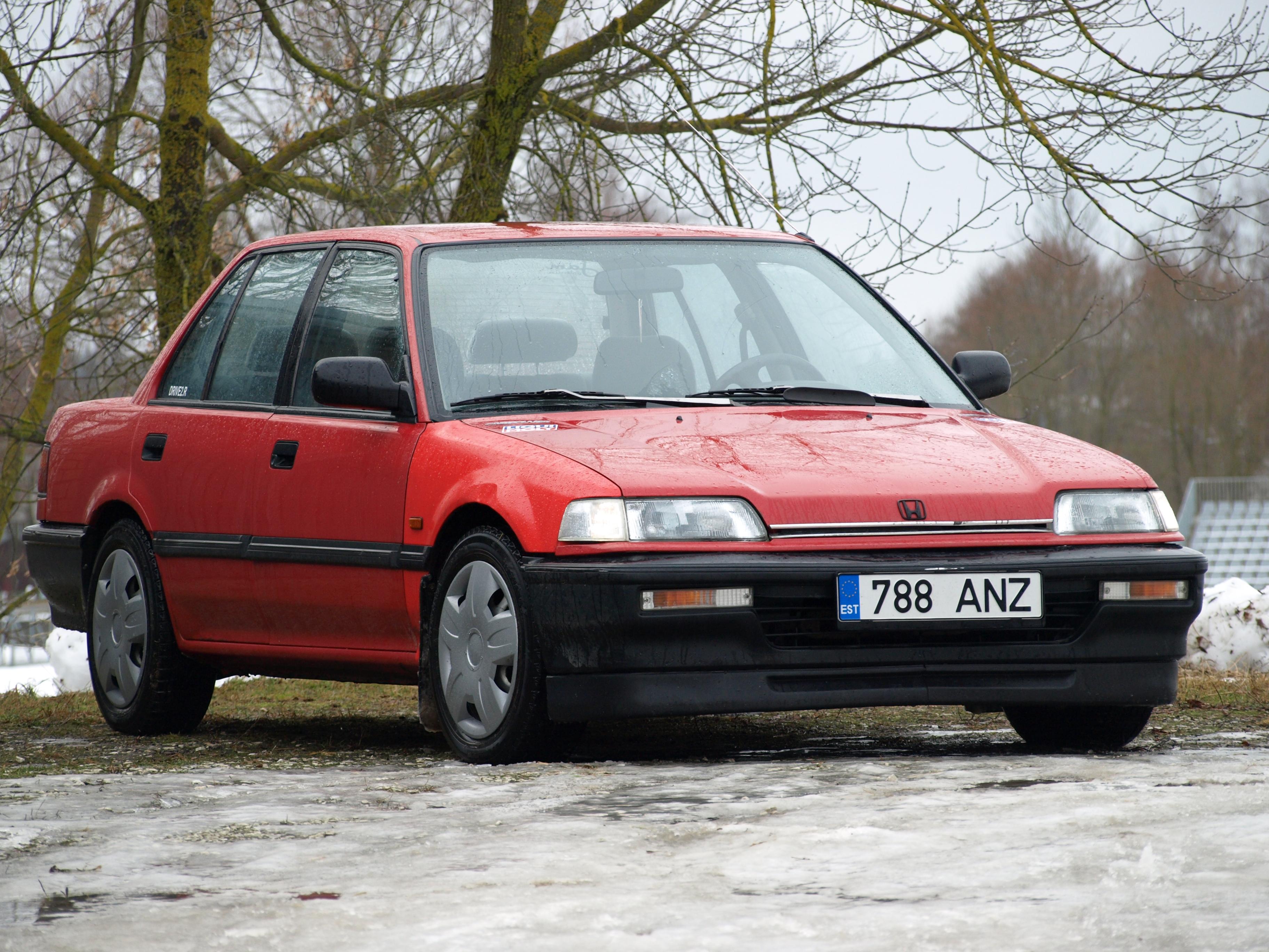

Nice. Most of those older cars have rusted away in my area, it's rare to see anything that old.
License plate ---you are in *squints at tiny print* Estonia?

Yes, i live in Estonia.

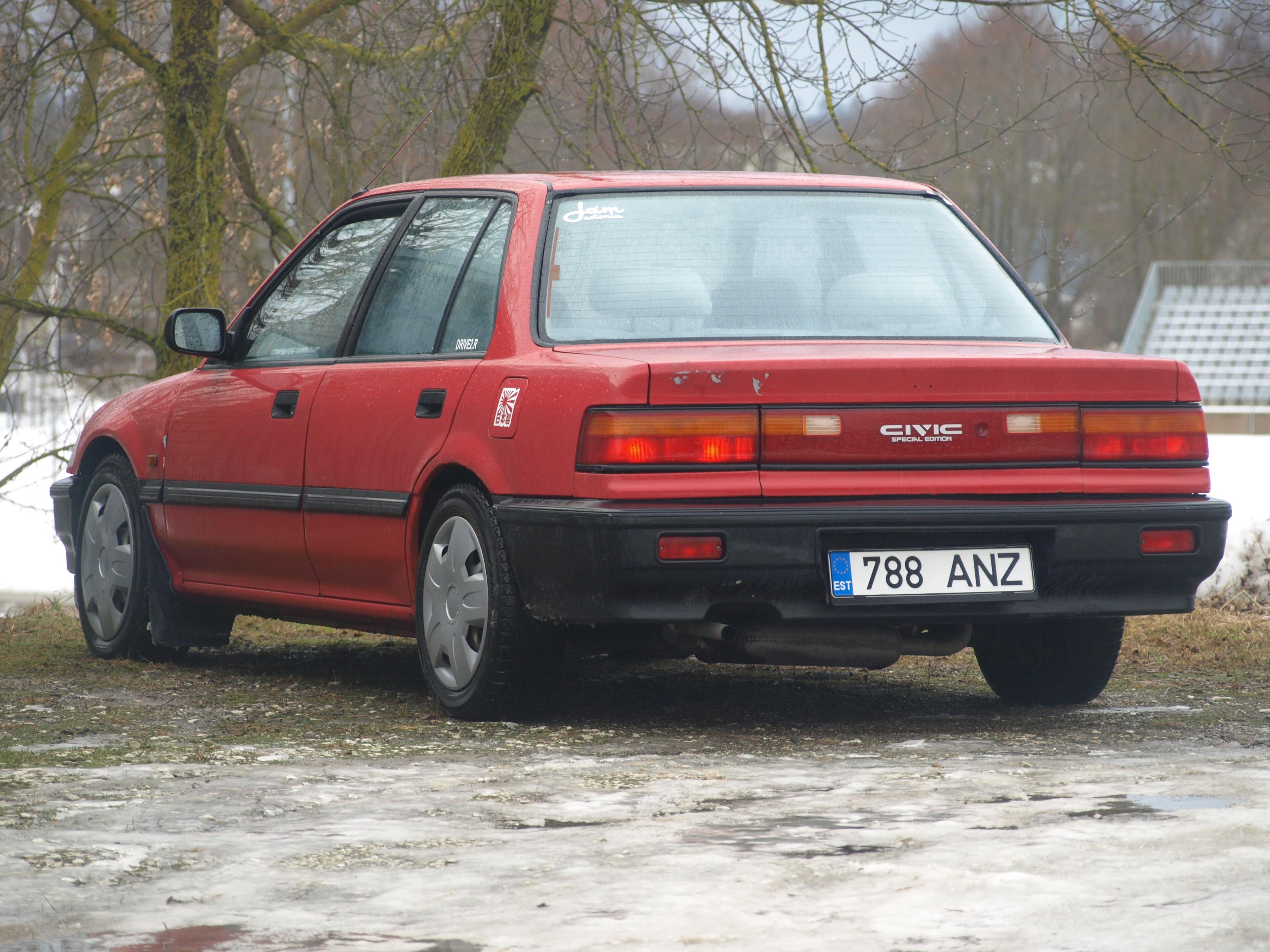

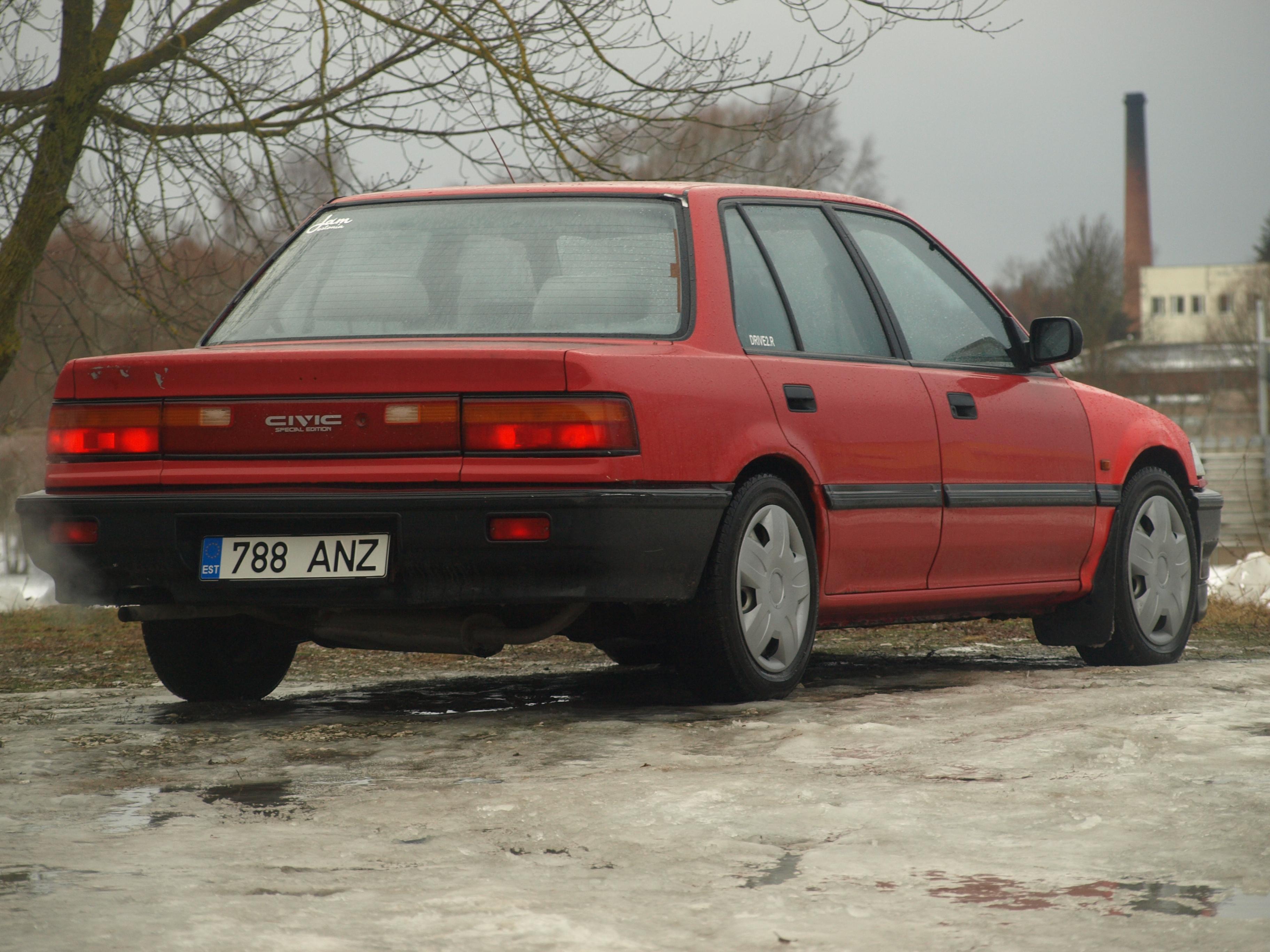

the car is somekind of special edition, I dont exactly know what makes it so special, but it has 4x power windows, so thats something they usually dont have, and they all work perfectly.

Other than that im very happy with the body condition, it has a little rust on the rear wheelarches, nothing a little work cant fix.

I like the car because It can easily fit 4 persons in it with enough legroom in the back the feel comftrible and without the hassle of the two door. The trunk space is huge considering that the car weighs under a ton. The engine isnt nothing fancy but when driving alone it pulls you to the seat quite nicely.
