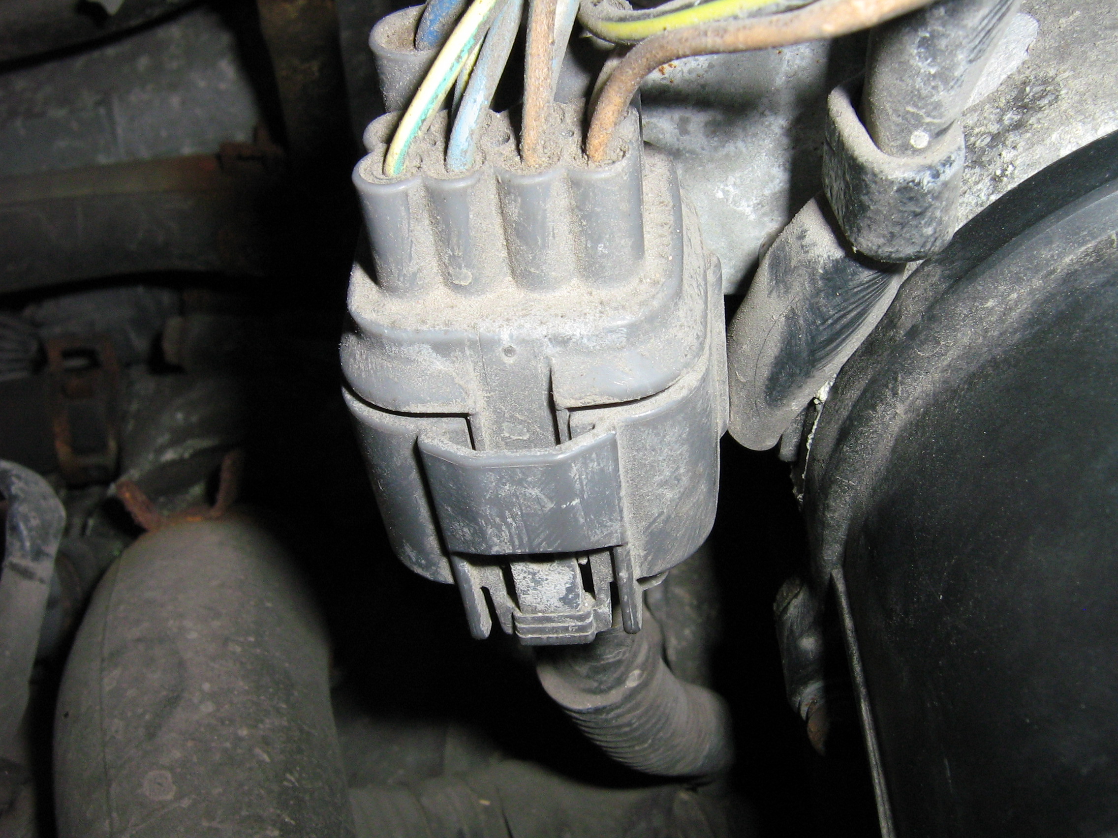

How do I open that multi-wire connector on the side without breaking it? See attached pic.

I did manage to open the distributor connector, and took the distributor off, and in the process of removing that broken cap screw.

Only thing I can think of is that as I moved/disturbed the distributor connector, and it restored some connection that was failing before.
Interestingly, having seen the insides of that connector, I could not see any sign of corrosion, it seems to be a well designed and weather proofed connector.
