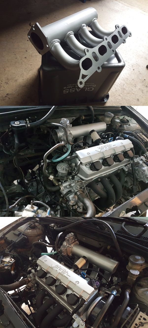

...well after like three months the engine is rebuilt again... this time I clocked my pistons right (I hope) and removed/replaced the broken water pump bolt which lead to the timing belt braking.
As you can also see I built my own intake manifold ended up costing me $1100, mostly tool cost like welding gear, saws and clamps; as well as the water cutting fee to cut the plates I designed and 3d modeled. I tried to weld the final piece on my own but ended up warping the hell out of it and it looked like ****, so for the final version I spot welded it together and payed a shop to weld/seal it up.
Looks friggen epic IMO!
At the moment I just started her today for the first time with this manifold. I have a crazy high idle surge from 1100 to 3000 up and down rhythmically , pretty fast. With the IACV unplugged (Idle air control valve) it will idle with a fast lope at 1000rpm. So naturally I thought it was a faulty IACV from the j30 throttle body...
But I unplugged the j30 IACV and then plugged in my stock d17 IACV (not installed into the j30 TB, just in the open because I wanted to see if it was moving open and closed) and the idle still surges but the D17 IACV does not actuate and since it is not connected to the j30 tb on the vehicle it can not cause the surging.
The only two things I have connected that could dump more air into the system are the IACV and supper noob question here, but the electric component that comes from the fire wall to the fuel rail then into a cylinder, then into an electrical control valve and finally to the intake manifold. What is that thing? I am having problems trying to find a diagram of the way it is installed stock and what it is called, in order to research the issue.

Haha figured it out. It was actually a massive vacuum leak because there was a vacuum port left open on the underside of the j30 TB that I forgot about because I ran all of my stock vacuum lines to the manifold. Took me like 45 minutes to find it as I slowly puffed a cigar and blew it into the manifold.

Glad you found it and that intake mani looks awesome!! That is a thing of beauty, great job!!!

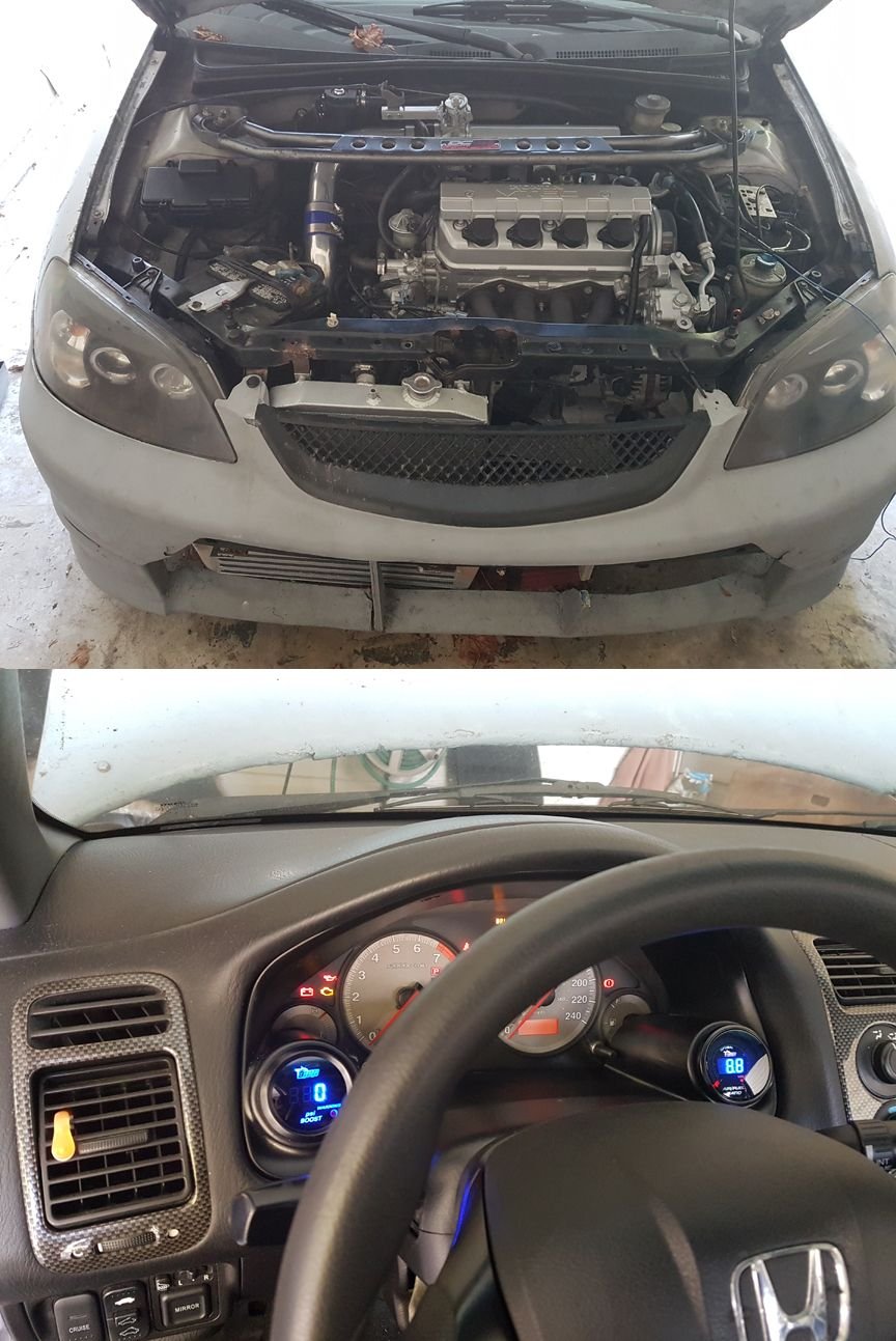

Re: mac25 build
Intercooler is in, j30 throttle body now working with custom intake manifold, gauge cluster installed, air fuel and boost gauges and sensors installed (well I still need to wire the third party rsx-s air fuel sensor, that's why that wire is hanging out), rsx-s fuel pump, oil catch can, remote exhaust cutout installed, because rice =D.
Still need to install
-injectors
-plugs
-SC mount
-sc14 supercharger
-supercharger oil cooler
-aem FIC (...stupid emenage is in the trash now)
Also, as you can see I smashed the front end, trying to park the car on a farm, at a house party... lol. One day she'll look pretty, but boost first.
