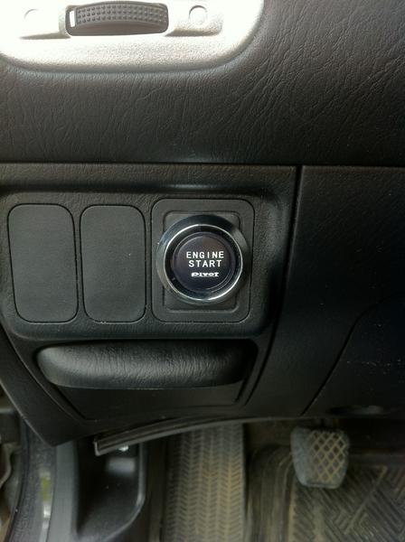

I painted them using Krylon hammered finish silver for plastics and Krylon Clear over top.
So, some of you may disapprove, but I just had to :P
The only thing I don't like about this particular design, is that the button lights up blue only when you press it, and I wanted it to light up when the key is in the on position. Oh well.

It think it's nice I can't have a start button at that place, because all those 3 places are already taken in my car (1. sunroof 2. electric mirrors 3. headlight hight adjustment)

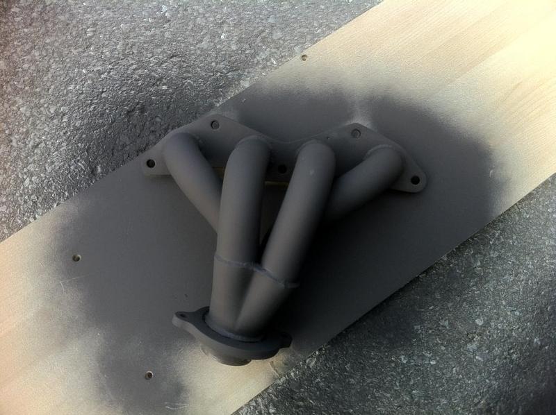

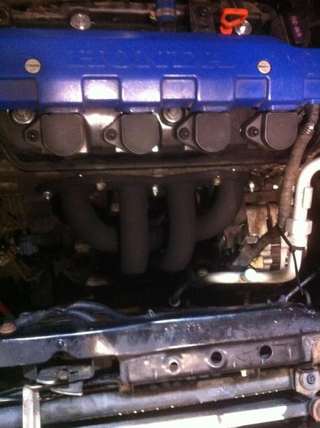

UPDATES!
-Got the old manifold off, had to take an angle grinder I had to the nuts and grind them off. Once they were off and I had sheared the lower manifold spring bolts in half, the manifold came right off, and some vise grips were all it took to get the old stud out the aluminum head. I picked up new studs, nuts, gasket, and spring bolts, and here are the results:
I also have a 2.25" EX "Test pipe" on the way, which is going to get cut up for the cat to be welded in.

Nice!
Looks clean.

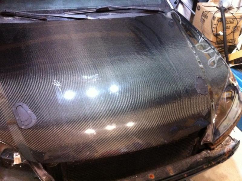

Got some pics of the new goodies!
The first pic is the new hood latches - I'm really liking the look of these things!

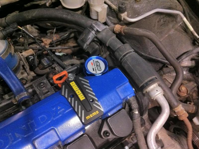

The second pic shows the mugen oil filler cap and one of the momo "Nero" pedals.

Progress on another y8 mani swap!
I like the hood latches.

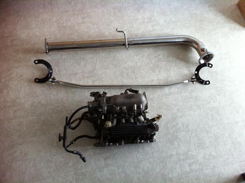

More goodies!
Gonna start measuring up the test pipe for the cat and slicing her up...unfortunately, unlike the pic I saw, this thing only has one O2 sensor bung, so I'm gonna have to put one in behind the cat...oh well.
After that's done, I'm gonna strip down the manifold and start the process of cleaning that bugger out...it's a bit dirty!
Question for you all:
Should I paint the intake mani gloss black, silver, or just clean it and leave it like that?

Black I think.
I've painted a few of my engine parts silver and it shows dirt pretty badly.
Old Oct 19, 2011
  #84
Seby05's Avatar
Joined: Jul 2011
Posts: 152
Rep Power: 182
Seby05 has a spectacular aura aboutSeby05 has a spectacular aura aboutSeby05 has a spectacular aura about
Re: My EM2
I'd say black also, or just brush it really good and leave it like that, it'll probably shine up really nice.... no silver paint tho

Some updates -
Got the rest of the exhaust out today and started mocking it up with the new parts:
(ignore the mess in the garage, I"m a messy worker, and I have no toolboxes at the moment :P)
Ordered a new O2 sensor bung to weld into the pipe.
All that's left is to get/make some extensions for the O2 sensor wires and weld it all together, then it's time to work on getting the bumpers redone and get some side skirts and the front lip put on. After that, I wait, until spring time when the car goes back on the road and I start looking for rims and tires.
That's it for now, I'll have more updated once i get some more stuff welded together.
