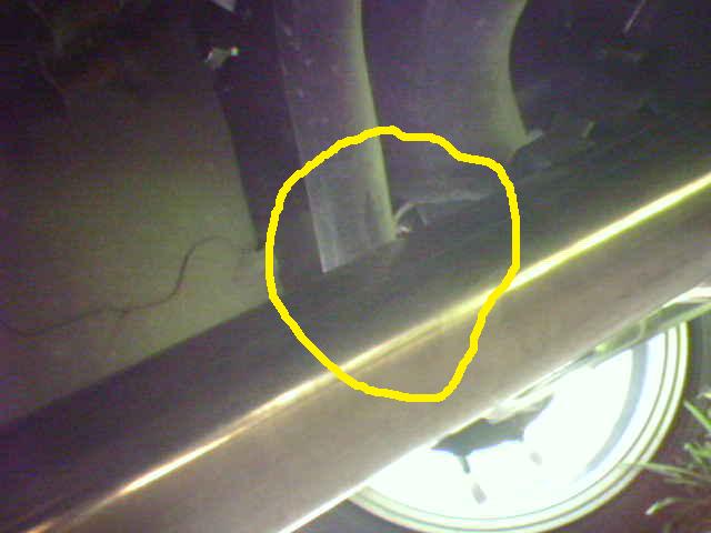

hey guys, I just got my magnaflow exhaust system installed today and when I turn or go slow sometime, but not always the exhaust seems to be rubbing against the control arm in the front the car. it doesn't do it a lot but it's annoying.
Does anyone know any idea on how to fix it and is it fixable? I would appreciate any help you guys would offer.

he has a catback... and its an LX... the cat is in the header on the LX...
Going to need more information, and/or a decent quality picture.

I looked under the car again and I was wrong, it's not the control arm, it's the sway bar and the exhaust seems to be vibrating. It does look like it's rubbing against the swaybar, I don't know why I thought control arm.
I took a pic with my camera phone, sorry bout the quality, it's an older phone.

common problem. easy fix is wrap some thermotec exhaust wrap around it.

or get the hangers readjusted

How would you adjust the hangers? Do you slide them forward or backward depending on what helps, or would you do something else. I appreciate all the help guys, I don't know much about fixing this kind of problem.

You could try to man handle them youself, or take it to a muffler shop and have them work it out for you. I just took off my front sway when I did my ex exhaust conversion. To be honest, I like it much more then having it on.

^^ exactly what triz said, take it to a muffler shop and they'll know what exactly what to do. they'll bend the hangers and make the exhaust sit higher so it will stop hitting the sway bar. Shouldnt cost that much either

ahhh cancel your appt w/ the shop! just go to an auto parts store and buy longer rubber hangers for the axleback part.. it lowers it a little bit to clear where the metal is touching.. I know from experience, and this works

I took it to the shop and they had to lower the exhaust by half an inch to clear the front sway bar more. It still rattles against it sometimes, it's a little annoying, but it's definitely better than before.
What other options do you think I have to stop the rattle?
Where can you get that exhaust rap I saw someone mention?

what I was saying is that the exhaust is hitting the front sway bar. I was looking for an alternative to fixing the exhaust besides lowering it more.
Would replacing the sway bar with an aftermarket one fix the issue?
Is the thermal wrap a good idea?

Take off your front sway bar, measure the diameter. Go to the nearest hardware store and buy radiator hose of the same diameter. Take some windex and spray it all inside the hose and along the sway bar. Take the hose and just slide it to where ever you need it on the sway to keep the exhaust from rattling against it.
Same can be applied to the rear.
