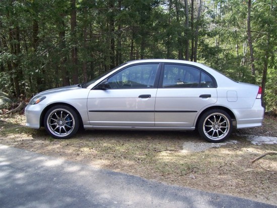

Alright so I've been thinking about painting my trim peices on my VP 4 door for a while now, but I haven't found a place that sells OEM paint until LT2004 brought it to my attention.
Here's my car..
and here's the paint..*courtesy of LT2004*
I want to paint the trim, handles, and side mirrors w/ this paint, and clearcoat. My question is do you guys think it can/should be done? I've painted my grill black, and what not, but I haven't done anything like this before. Obviously I would have to sand it down and everything, but what do you guys think? Am I being cheap and foolish not to take it to a bodyshop? or should I go for it?
thanks!
