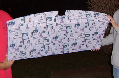

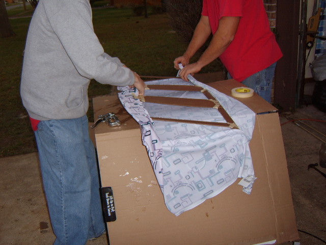

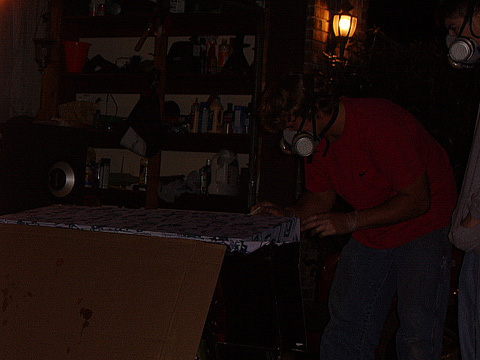

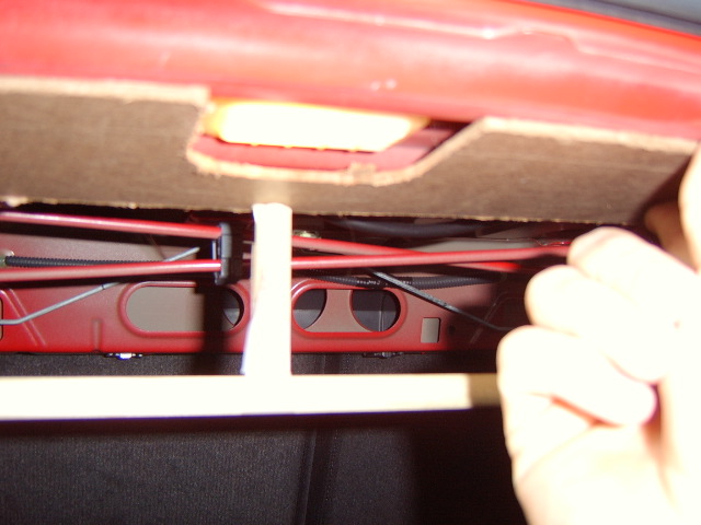

Here is the pic that we took today and resined the first layer....
Its going to be place like a ceiling in the trunk, covering the bars and 6x9's.
Making a place for the trunk light.....this will also give a define curve shape
Don't you love our table!
Finished the template. (Didn't chose material for design....just for the elasticity)
And then added the resin.

Post more when ur done.. i wannna see..
