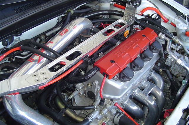

I thought Kamikaze header looks great if anybody says stock looks better they need their eyes checked....

Kamikaze not good....
Though it is a nice header, the kamikaze will make you lose power due to the size of the tubes. They are more geared for cars pushing very high pressure like turbo/supercharged cars. I had one and had my car dynoed and it actually came out with less power than my previous header which was a greddy. I put the greddy back on. I recommend one of those or a megan/hp header. Go with the kamikaze if you are pushing out some serious power.
