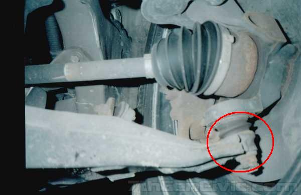

Ummmm so yeah I crasehd my car today. But thank god it was only the shell and not the frame that is damaged. I may have snaped something were the tire is, does anybody see that crack near the bottom were it connects at the bottom. Also any body kit suggestions?
Is that a crack or is it supposed to be there.

If that is the crack that you are talking about then I would definatly get it fix cause that is part of your suspension and steering mechanism. Cause that's your Tie Rod that's cracked.
Get it checked out soon!!!

I'm happy my car isn't a write off. This is my first real car that I bought and I was two seconds away from snaping. But my dad is making sure it won't get written off. Well what happend I got cut off by a truck going on to the highway, it was a two car on ramp and got cut off well more of forced into the gaurd rail. Plus I get to pick the parts to replace. So I guess that is a crack than, gotta get that fixed. I'm not thrilled but you gotta look at the better side of everything. I get to keep the car, maybe a body kit, fresh coat of paint. List goes on and on

yea...looks like it's cracked in the tie rod area. like fly said...get it checked out soon...might need some replacement parts. haha...you do seem happy aobut this situation...especially in the 3rd picture...looks like you're posing for a picture after you won a trophy or something, lol

Yeah I'm getting a body kit put on, but I'm not into those fenders, especially on the 4 door. I already got the fender and bumper off, going to the garage tomorrow for that crack by the tierod. CV joint looks alright thank god. I'm impressed how it stood up, it was solid. Head light even worked afterwards. nothing to the frame that's all I cared about

I think that crack is on your lower control arms ball joint area. The steering tie-rod is mounted up top.
