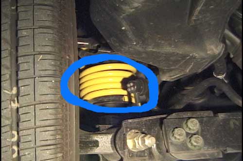

so basically its this section of the spring?

Yup, those are the dead coils.
