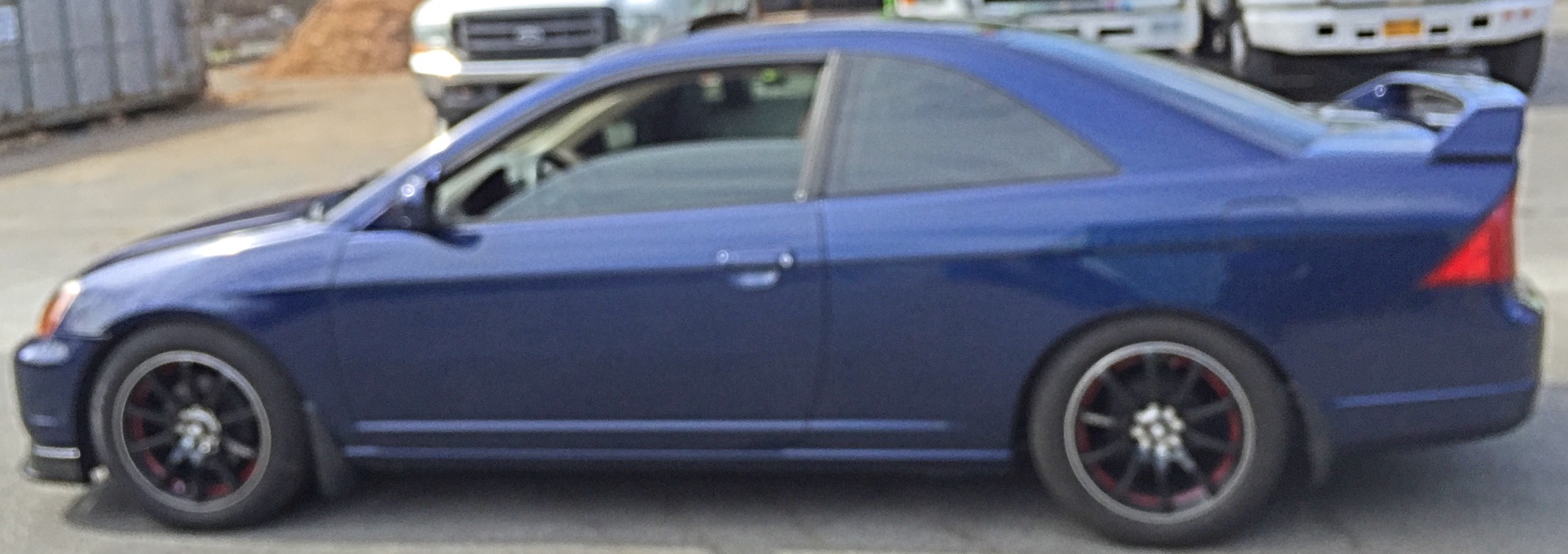

02 Ex coupe dropped on Tein Street Advance coil overs. I got camber kits front and rear. Also replaced ball joints for good measure. Advice, don't go cheap with a drop it could be dangerous. Better do it right so you don't have to do it twice. You need at least $1,000 to do this right. But the end product will be much nicer and safer.
