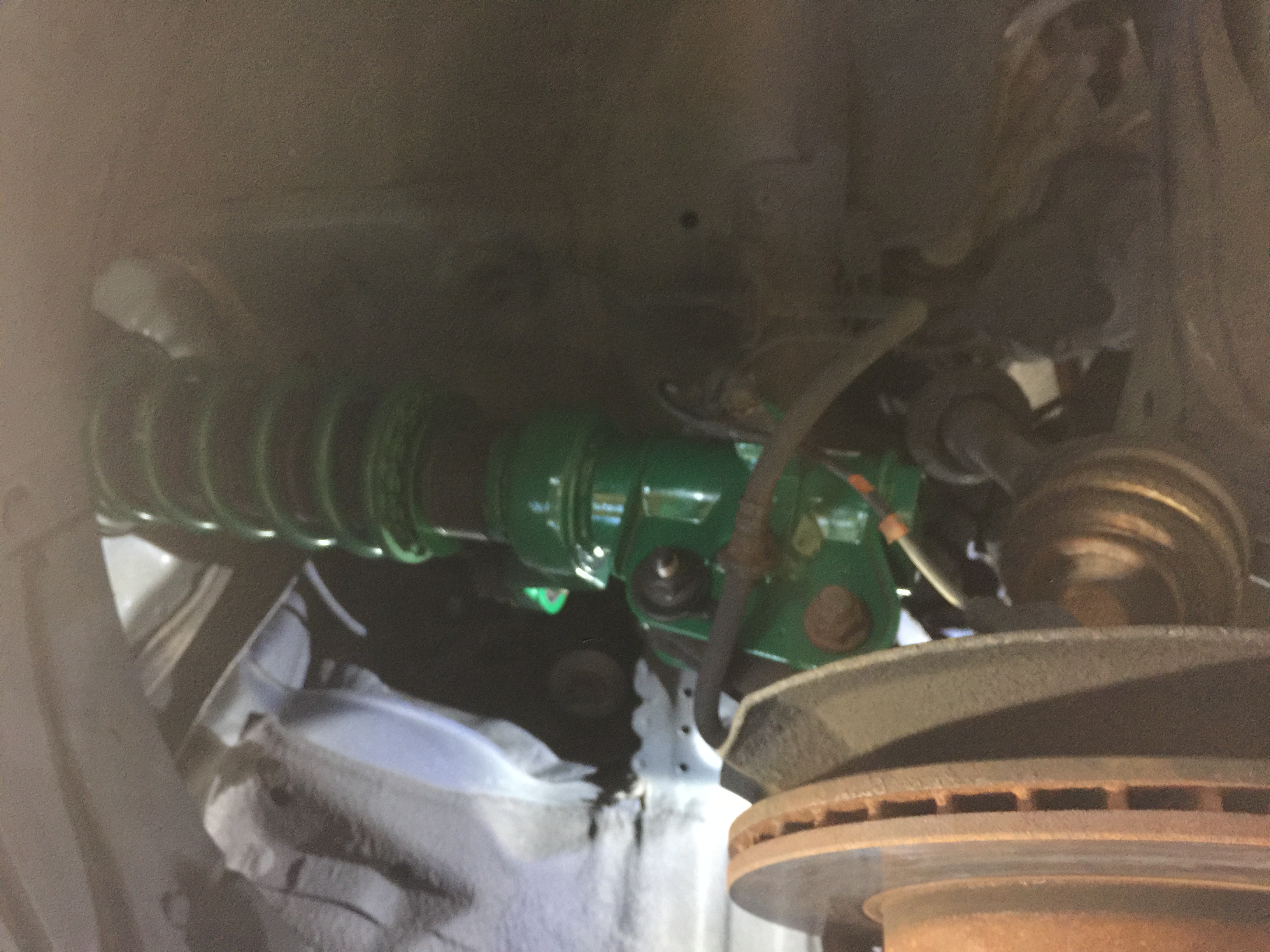

I will be installing these very soon on my EM2
ID:	88564   Click image for larger version
Name:	Tein Coil Overs.jpg

Dropped on Tein street advance coil overs
