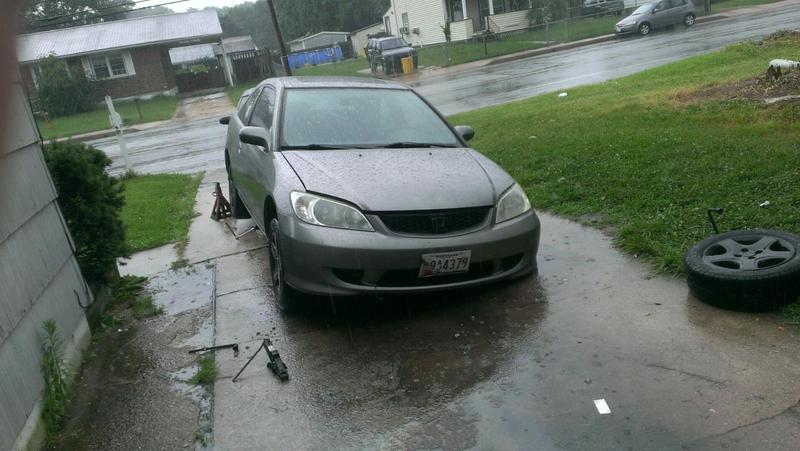

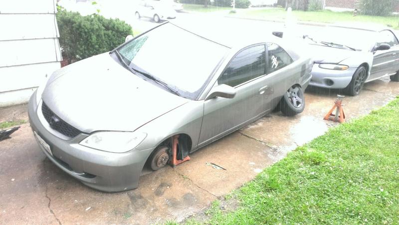

Well get this, got the new tires on, they did an alignment check and I'm going to need one. BUT! I Can't do it until I replace one of my rims that is apparently twisted. Then! To top that, my car ended up falling off the jack stands yesterday so I have a feeling I'm really gonna need on now.

Moving yes, but I either need to get new fenders or repair the ones I have.

Let's be Very Thankful no one's head under the car when it dumped
