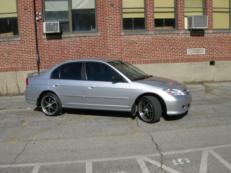

Here's the pictures guys. I will measure tomorrow.

this car is on stock suspension with 18s.

I would say it is lowered. That pic lowlife posted is a monster truck.
If the springs are black then it could be an Eibach pro kit or someone cut the stock springs. Your going to have to remove the wheel and look for writing on the spring.

Yeah her car doesn't look anywhere that high in that picture. Dang I was hoping it wasn't lowered. The ride is too good to be cut springs so Im hoping some lowering springs are in there but I will look for the writing when I remove the wheel today.

take pics of the springs, might someone reckon them. lowered.

Looks lowered about an inch.
