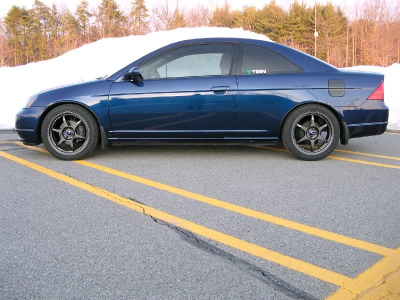

about the spring setup vs coilovers bit.. Not necessarily. I achieved pretty much what OP wants with Tein S-Techs on Tokico blues. Had 17's with 215/45 tires to accompany the drop.
Setup ran me just about $700.. $800 if you wanna count the alignment, and about $950 if you want to include the camber kit I installed along with it.

Then again, that's not the setup I'm running right now.. Shortly after that picture, I came across a deal on the forum to get Tein SS-P coilovers for $1250 shipped from SoCal to upstate NY.
But, to keep from going off topic, if OP is interested in the same setup I had when I took that picture, Dezod.com is a good place to go. Shipping prices kinda suck, but they are an authorized dealer with amazing customer service. Their site started out offering either universal parts or 7thgen specific parts, even fabbing up their own turbo kit before moving onto different platforms. You can get a small discount using coupon code "7thgenhonda"
Those wheels are 17"215/45? It looks good, that's about how I want mine to look with the Tein street basis coilovers.
