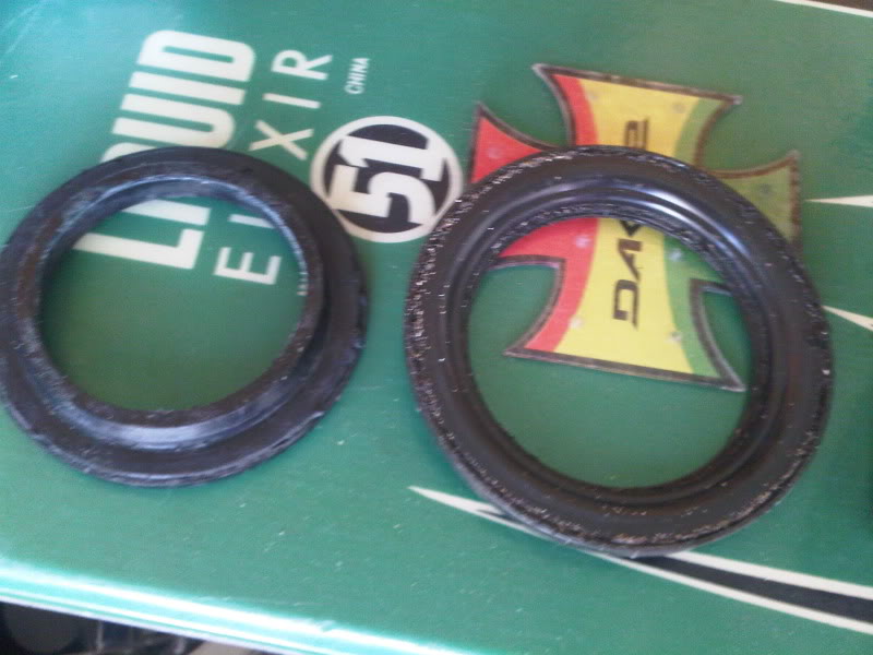

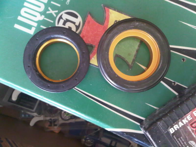

heres what the bearings look like.... its incase in a little housing (the metal part)
01-02 of the left, 03+ on the right

note: not the gold part, thats apart of my grondcontrols setup.
