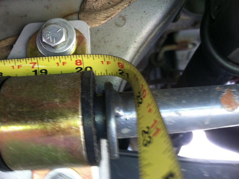

Hey GolNat, would you be able to do a huge favor for me? (or anyone else for that matter)
Could you take some measurements between the bolts on the LCAs/sway bar? If you could measure the 3 distances on the drawing I attached I should be able to locate the holes.

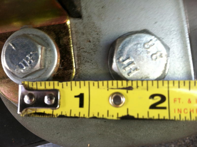

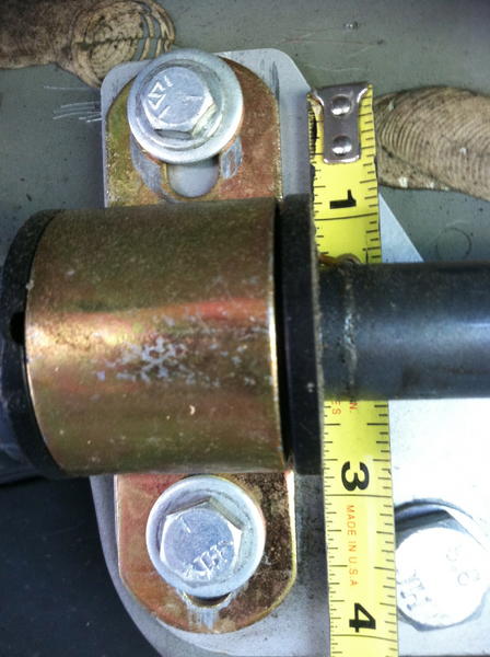

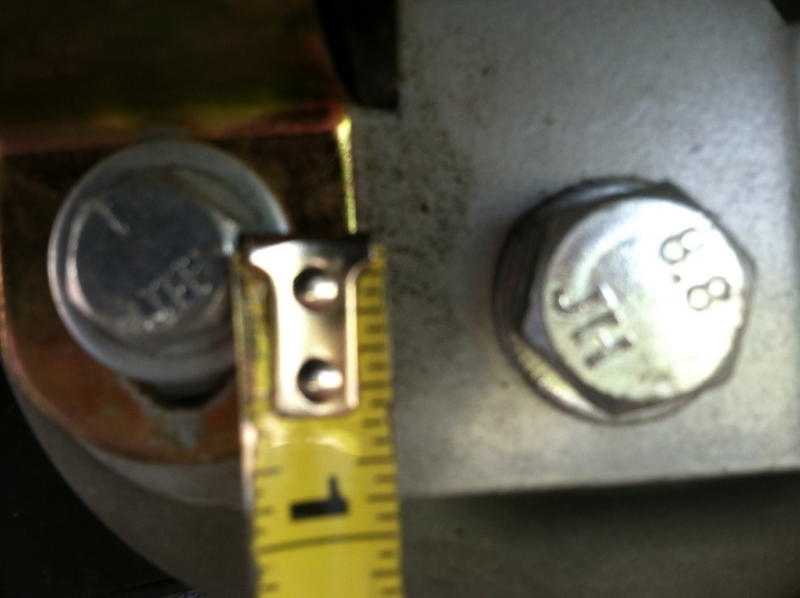

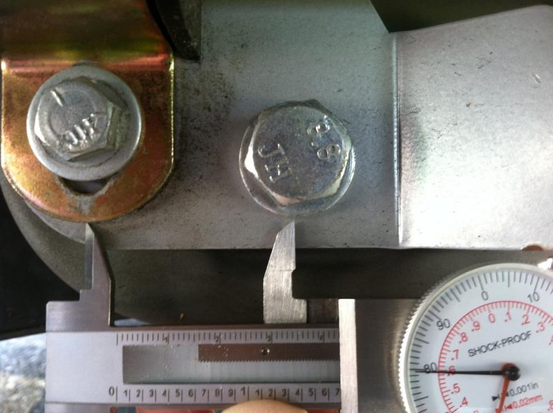

Dimension 1 - Pic 1/2
Dimension 2 - Pic 3
Dimension 3 - Pic 4
Pic 5 is the dimension down from the bottom bushing mount to the lower control arm bolt.
Dimension 1 looks like 1.680in
Dimension 2 looks like 3.25in (I would use the bushing bracket for this dimension and just measure n=between the slits)
Dimension 3 looks like 19 7/16 - 19 1/2in
Hope this helps. Let me know if you need anymore measurements.
