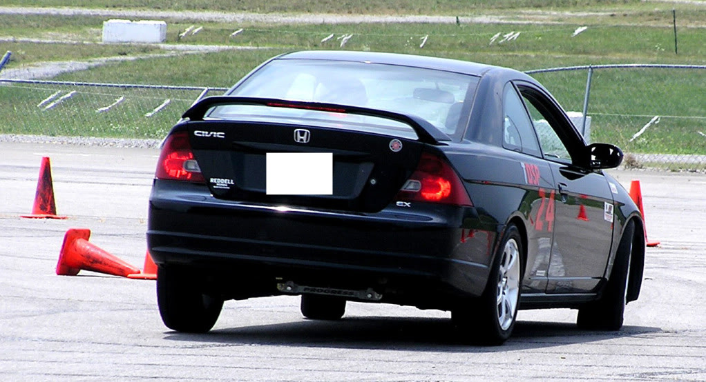

I fully understand that...
I keep looking outside to see how the car drives and corners when leaving the alignment shop for the test... Hate the photographers that comes to our autoX - they post the pics everywhere but on the SCCA forums... I usually take the pictures on the events that i don't go run, so i have pics of most everyone, but mine...
That's when i can trully see if the suspension is working, but i can't because i can't take pics of miself driving...
Example - just after correcting the rear camber to -0.5 and progress rear sway, but 0 camber fronts...
Originally Posted by Shift-E
Where else would they post auto X pics? World of Warcraft Forums?
You corrected your camber to 0F and -0.5R? Was that to establish a baseline?

in the SCCA central TN home page, actually - we keep trying to find out who was tooking the pics to see if we can get a copy... maybe they trying to upload in FB or someplace, but most does not delete the number plates before posting. hateful...
And yeah, sadly the correction was from 0/-1.5 after the pro-kit install. I did not know suspension setup so well at the time, so ran like that.
monster understeer, and i had the eibach sway setup (made worse...). huge wheel spin that killed my trans... it's rebuilt now.
after that pic, i finally found an alignment shop that knew camber bolts and finally agreed to set the fronts at a more humane -1/-0.5.
then moved to quebec and couldn't find a darned shop that would make custom alignments and i was back to 0/0, with the outer shoulder wearing down again...
now back tn, and the alignment guy is still there. hurray!
now running -1.5 / -0.5 -> heavens, finally!
I should actually had shoot for the -2/-0.5, but that is for the next round

Got a better shot today.
