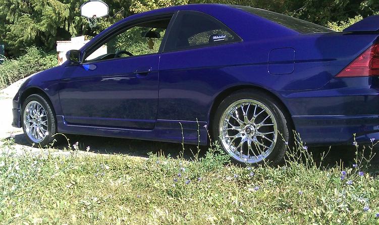

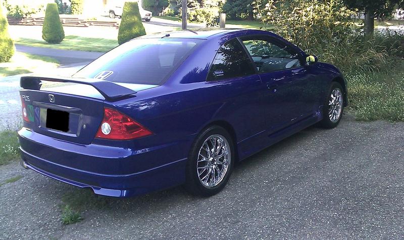

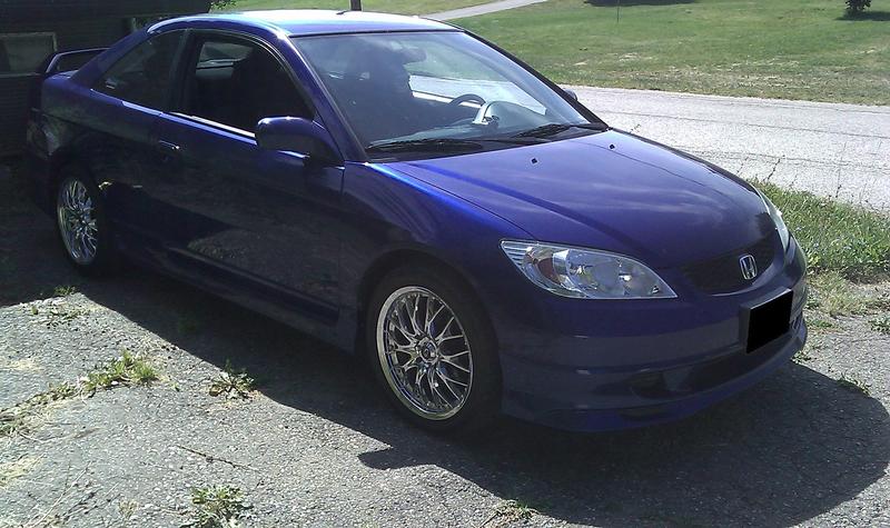

Hey guys i was thinking of lowering my 05 Civic Reverb and i was wondering how low should i go? The drop will have to lower the front more than the rear because of stereo equiptment in the trunk. Im sure you have lowered you civics and know what the end result will look like.
Just looking for a few suggestions
Here is a few pics of the car

looks nice to me like that and u can still get over speed bumps xD

i would not go more than 1 inch drop esp in canada. even then the ride quality get much firmer than stock.

****, what the hell is in the trunk. The back already looks dropped!

Yeah my system really lowers the rear already but I really only want to lower the front but i have talked to a couple of the local mechanics and they are telling me not to becuase then i have messed with the car's geometry. Has anyboody done just a drop on the front before?
