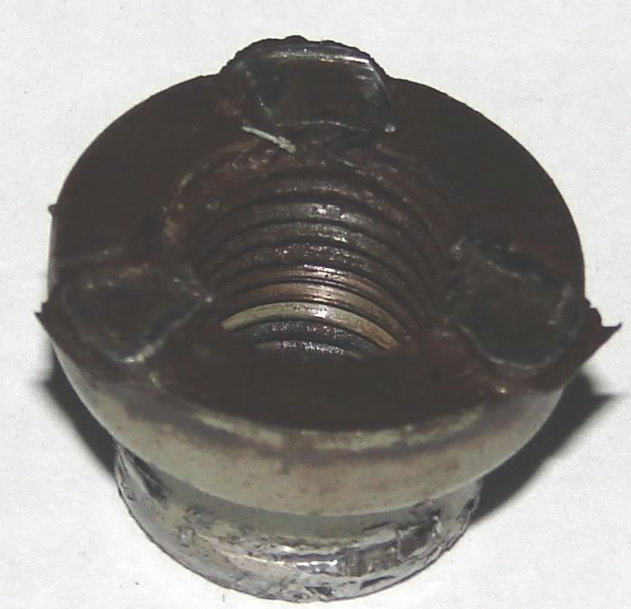

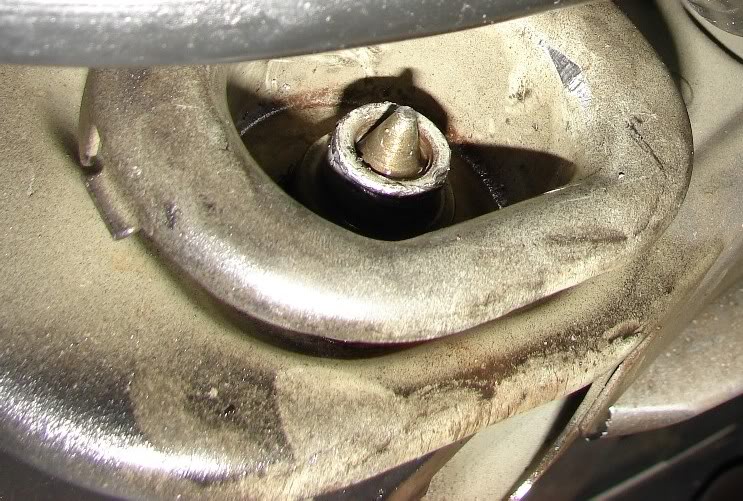

Nut weld came loose and can't get the bolt out...
There's no space for vise because of the strange metal around it (why is it there anyway?)
Was thinking on welding it back using a spot weld. Can't even cut it out because of a (Eibach?) brace does not give clearance for a saw and heating the nut did not help much...

No, the nut is supposed to be welded in there, circled by these strange stuff. It does not have a HEX, it's simply a smooth round nut with threads... Hate, hate, hate honda engineers!

Tried both, actually. both will be straight in the direction of the bolt, so can't get torque enough to take the bolt off (last portion might be stripped...)
Ah, tried using an electrical impact wrench (which helped me tighten back the suspension wile I think what to do), but could not take it out becuase vise will come loose.

nothing like a bigger vise - found a bigger neddle type and was able to take it out. Nut have 3 protruded parts under the nut which fits on similar slots in the suspension (welds?). Anyway, time for a spin and count the number of bolts that will fall in the way.

See the lovely fella here

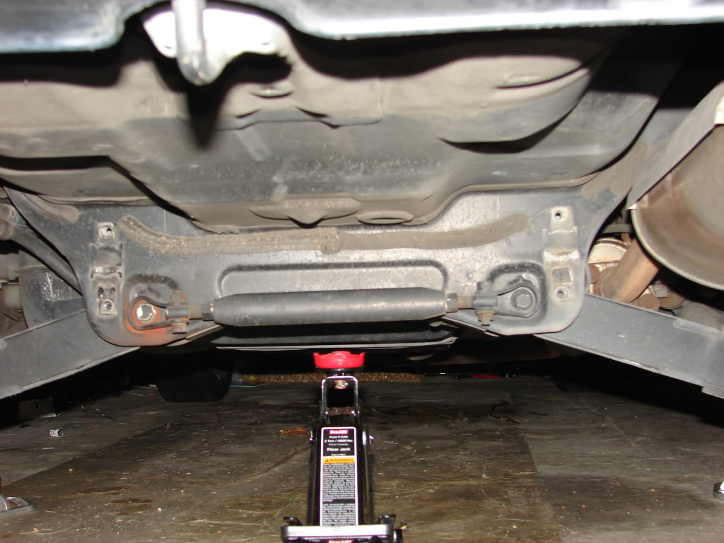

But now all is well, after the new vise grip
Car drives well beyond the limits before, way less understeer. Need to recalibrate rear and front shocks now.
