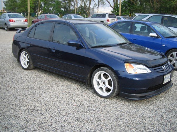

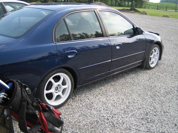

Ive done the research on the forum but no one has pics on Neuspeed sports for a coupe installed in a sedan. Everyone seems to think that the coupe will drop the sedan's rears a little lower. That would be wicked if anyone has a pic. I have eibach sportlines and that rear sag is a bit of an eyesore...
Cheers

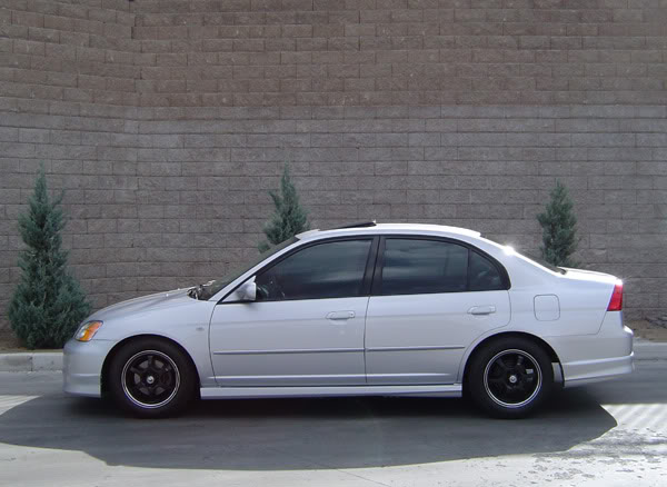

Re: Neuspeed Sport (coupes for a sedan)
look ma no sagging with coupe springs and tokicos.

To the OP, do you have sub(s) in the trunk, or do you carry anything with some weight in the rear, like the golf clubs in your trunk?
I used to have neuspeed sports on my coupe, and yes the rear was lower than the front due to having a sub. Although, I took the sub box out one day, and it gave the car an even gap all around.
