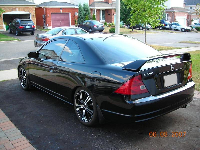

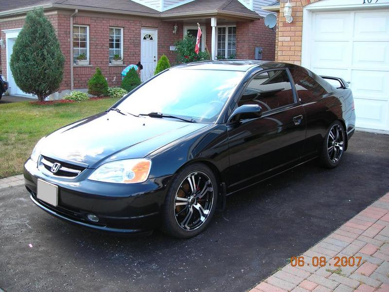

I just had a few questions regarding the suspension on the 2k1 civic ex coupe, and I was hoping someone would be able to help me. I lowered my car recently by myself with the Skunk2 springs. I got the springs from a friend and I believe the drop is about 1.75 but I am not 100% sure. I also got 17 inch rims with 215/45-17 tires. But I did not install a new camber kit because at the beginning it didn’t look like it needed one at all. I got the alignment done at the shop, but I forgot to get them to check the rear to see how it was. The thing now is that after a few weeks, the car dropped a little bit more, and the rear wheel is slightly leaning towards the inside, like we normally see on cars that don’t have the camber kit. My question though is this, with the car the way it is, I can barely put my finger on the top of the rear tires because of the small gap that the car has between the fender and the tires, and I am afraid that if I install a camber kit, the upper side of the tire is going to come out more and start hitting the fender on the car. Does anyone here have a similar setup? Or has experienced this issue? As for the front, I believe I wont need one since I was able to get it aligned successfully. Does the brand matter for Camber Kits? I see that most camber kits are from -4 to 6, not sure If I need more than that, but probably not. Also I am still riding on the original shocks, I am pretty sure they will give up on me after some time, specially the front ones, so I have been going easy on them. But what would be the best brands for this car? I saw someone selling dropzone struts on ebay for this car for a really good price, but I am not sure if I should rely on them: (http://cgi.ebay.com/ebaymotors/ws/eB...WA:PIC&ih=003). Any comments on these? All the info you guys can give me will be greatly appreciated.
