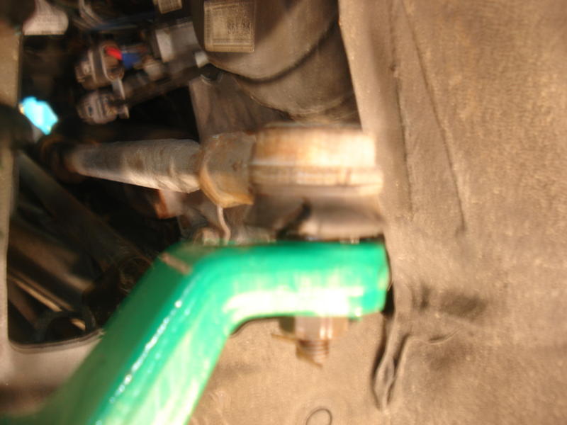

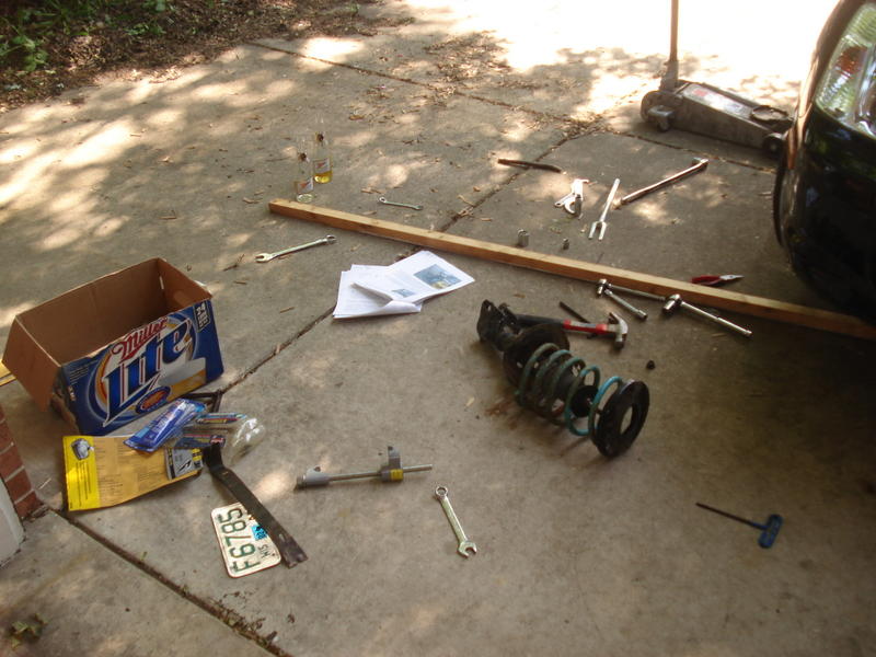

Ok, last weekend i started my tein basic coilover install. Thanks to mex for his printable DIY it gave my cheap printer a workout but it was well worth it. I posted pictures of the project and i'm still currently working on it for many reasons. The fronts i got off with a torn tie rod boot as my only victim. pretty easy install, took about 3 slowly drank miller high lifes worth of time. then came the rears, i was all ready to go when i found that the 17mm bolt wasn't budging. No impact to use in sight. So i used my buddie's gf's run down Hyundai accent to run to the local hardware store and pick up a socket to fit the breaker bar i had. Soaked it in pb blast. then tried again. no luck. Hammered on it. no luck. put an extension on the socket, attached the breaker bar, came through the wheel well (for more leverage), attached a jack handle to the break bar, put everything i had into it. and it torqued the extension in half. No luck. So i gave up on the project until i could get an impact wrench. drove my car away, and found my steering wheel to be cocked to the right, while i was driving straight. I'll continue on that in a bit. Got an impact from a guy at work last night, and found my 17mm impact socket to be too long to fit that with the impact between the bolt head and the rear suspension link. I finally finaggled it in, impacted away, and the bolt still won't budge. I'm getting pretty frustrated at this point. My new options are, torching the bolt, and i'll buy one more non-deep well socket today to give it another try. So here are the questions i have. Any other ideas on how to get that rear bolt out? I have read that in order to replace the tie rod boot i'll need a special honda tool. anyone have any "alternative" tool ideas to use to replace that boot? what's up with the crooked steering wheel? i've read on here that it's an alignment issue and once i get it aligned it'll go away, but it seems to me that i'd need to lengthen one tie rod and shorten the other for it to straighten out. and lastly besides local shops, any nation wide places that do good alignments that you guys know of? Anyways, i'll take more pics of the final product when i finally get it done.

As for an easier way of getting the tie rod out without ripping the boot, don't even touch the boot. Take out the cotter pin and turn the nut so it's hanging off the end of the tie rod bolt. Then beat upwards on the nut with a hammer until it comes free. Then put the nut all the way back on and take it all the way off to straighten out the threads again. Worked fine for me.
