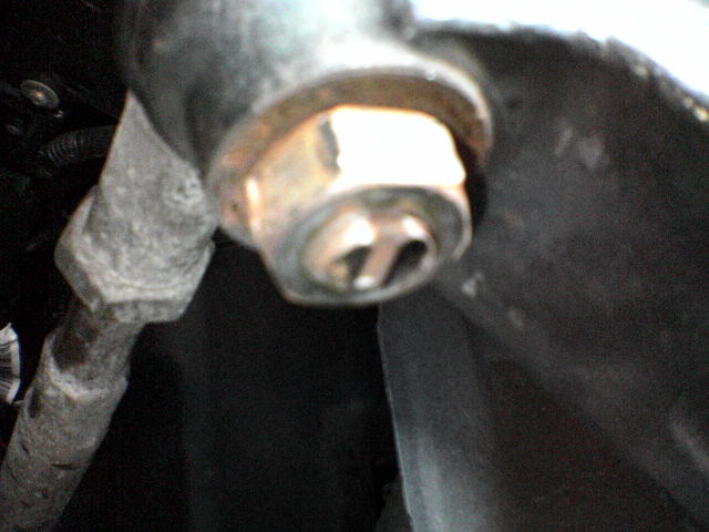

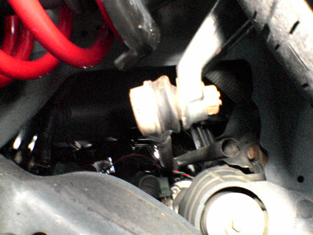

I just installed lowering spring recently and a shop helped me do it, I guess they forgot to install the bolt or didnt tighten the bolt. I drove over a pot hole and the tie rod came off on one side and I almost had an accident cuz I try to turn the steering but the wheel doesnt turn.
Long story short I took it back to the shop and fxed it but according the the DIY springs install, there supposed to have a pin holding the bolt (see pics below) but I checked there are no pins n not even a hole for the pin....
Anyone of u have the same issue?
Fyi, My car is 2002 EX sedan.

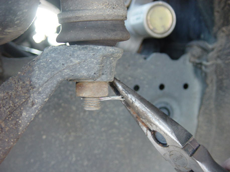

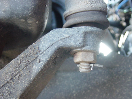

ya lower ball joint...... your suppost 2 have a castle nut..... and a cotter pin you prob dont see the hole because there isnt a castle nut

that is really dangerous, your lucky u didnt get into an accident cause as soon as that snaps, your wheels should go completely left or right.. make sure the bushing isnt bad, usually when you install springs you have to take that apart, usually a shop will just half *** it and break that ball joint while removing/installing. Its very easy to break if not done right.

I guess the shop might have damage it and cut the piece out...... so it ok to drive with just the bolts on without the pin?

Yeah that is extremely negligent on the part of the shop. Pick up a set of cotter pins from your local hardware store.
Think if you buy #7, the tie rod end, it comes with the boot already on and you just need the nut and cotter pin. You should check with whoever you're buying it from unless you don't mind having extra parts.

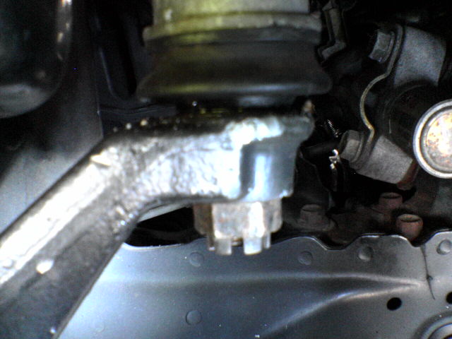

took some pics.... I had never have other shop change or remove my suspension/tie rod ends, only things I had other shops done was oil change, obviously this shop must have cut them....

yeah looks like they cut right where the pin should be, i would deff. complain to them about that.

The metal looks fresh as far as I can tell from the fuzzy picture. They can get out of that one. You really should do something about it, demand an explaniation as to what they were even thinking. They should have know the result of cutting the bolt so far in the first place. You definately should not be the one paying for the tie rod, or its install. But, if you havent got the tie rods on already just install them your self, it will be simple. The install is easy the alignment is the tough part, just try to match where it is now and get it aligned once your suspension settles. But dont take this matter lightly the shop screwed you and those pictures show what they did, make sure you at least get your money back for mess.
