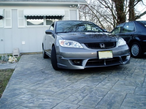

My cars on sportlines and Konis... does it look like this?
I dont have very many Non-action shots...
WOOT! 3 wheels! :P
(shameless self plug)
about the tow thing...
There are two rings on the rear koni dampers. the lower ring is the "stock" ride height, the upper is for towing (giving you more rear suspension travel)

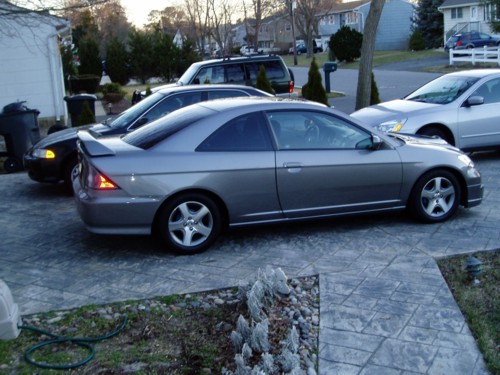

In the first pic, the front looks the same as yours, but the rear looks lower. In your second pic, the front of my g/f's car looks higher.
I will try and get some pics up soon, and hopefully the fronts settle a bunch or else a coil is comin out.
What color were your sportlines? Mine are a deep red.
Would cutting one full coil off each of the fronts affect anything? I would like to take an extra inch off the front ride height, and if they don't settle an inch in two weeks, i'll probably be cutting them.
