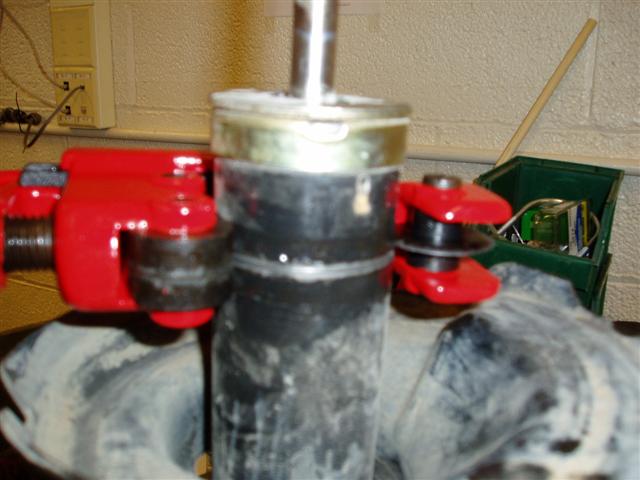

I don't know what you mean by strut housing. That's the reason I requested a pic.

Above the spring seat and below the shock piston. Measure that diameter. The stock ones are black, the tokico ones are blue, etc....

Well if thats the case my suggestion would be to buy the Tokicos.
But if you must, you need to measure the same place you cut.
Measure the diameter where the cutter is.
