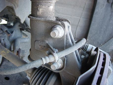

Sorry for my english, actually right now i am trying to put everything back, it's just the bolt that goes to the tie rod is striped and i know i will need to replace that one tml cause honda is close now, the problem i am having is i can't get the 2 bolts in. The picture is the 2 bolt i am talking about, I can't align the two holes it's off by alot.

just trying push and pull it around. use a soft-face hammer if necessary.

so i shouldn't install the top 3 bolt on the strut first, i should leave that to the end right?

just don't tighten unless you can get all your bolts in place.

The 2 strut bolts? just wiggle by grabing the disc brake then push it up. The bolts will slide in, try cleaning the dirt off the kunckle.

To put the stock back in, you will need to lower the control arm first. Give it a good push down with your leg. Then install one or two top bolts, but not tight so you have some 'wiggle room.' The tie rod bolt is a 24mm. You have to undo it then screw the tie rod end off. It might be kind of hard to do without being attatched to the strut. So you might want to install the OEM strut, undo the bolt then take off the tie rod end.
