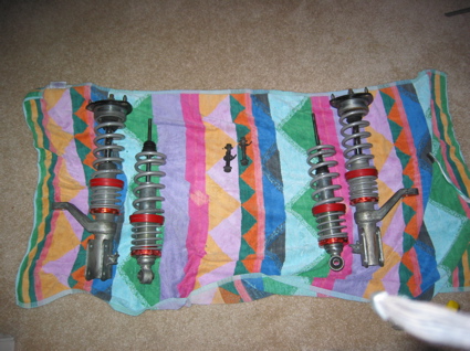

hey do this help if it does not tell me what part i need to take a pic of then i will take a pic.
im glad to help

^yah im pretty sure they are in right. Im not getting any movement from the upper mounts. Here is the spot from the picture posted above (Thanks for the pic!!)
Also I dont know if this matters or not, but my helper spring on the fronts is mounted on the top, and not on the bottom. Thats the way they came packaged so maybe they just re-designed the fronts.

i dunno - looking at where you highlighted the shock, that looks like a valve issue which would be in the coilover itself - nothing you can do about that but send it back. they have a lifetime warranty.
