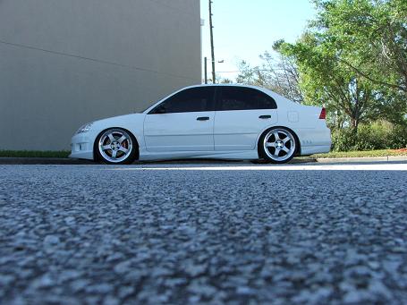

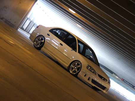

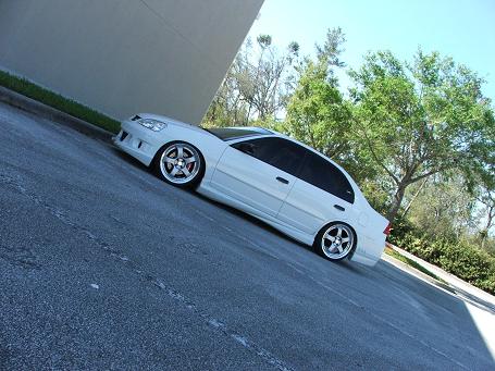

read this
hey man i had same problem., ur pillowball mounts in front come set at HELLA negative camber in the front.. i had same problem first time... jack the car up.... look at the top... and set the little line to the 0 in rthe middle.
that will set camber at a minimal and toe pretty straight.
right now i still have a little toe... 3/16 in ima get it adjusted monday...
im 2 little lines inward from the 0 and im looking at aboit 7 degrees negative camber which i like... thats just me.. the 0 should put it close to zero.
riley
im me if any more problems
rijowysock =aim
pics below...
i actually in the front removed 2 of the 3 perches today (locking the one that holds spring directly to the bottom mount... eliminating 2 because b4 i had all 3 together anyway...
anywho...this is max max max max drop.. lol.. show some pics once u get urs all done..

see my chrome bolts r in the middle (or near middle)

no 7 their like sideways but i have to have em like that cuz the fenders...
the rears are about the same cause fenders...
pics above...the guy at align place was yellin at me and like holy ****.. but i told him leave camber and juts adjust toe... which he screwed up 3/16in but thatl be fixed monday...
