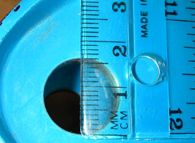

I took my Tokicos to a machine shop and they enlarged the holes with a bushing & hone drill, which is used in aviation for landing gears. I wish I would have taken my camera that day to show you guys how they did it. Basically what he did, since they don't work with metric tools either, was to convert the desired size(16 mm) to standard with a digital caliper, and got about 0.6299". The drill bit the guy used was adjustable and really long. He was able to get it exactly at 0.6299". The new holes came out great, aligned & all measuring 0.6299".
