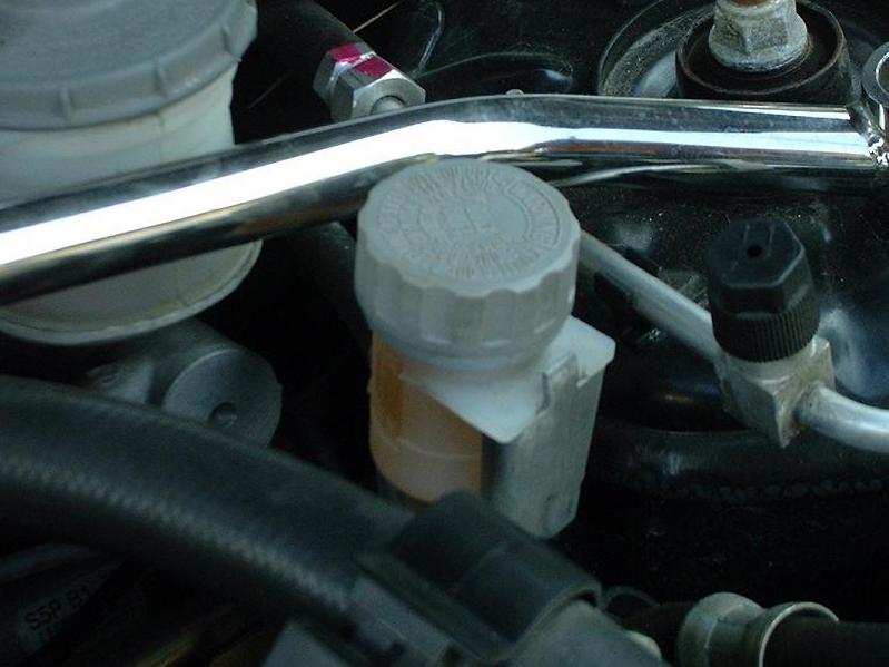

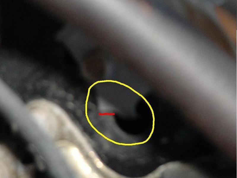

Alright here are my pics. The first is under the hood over shot, I put it forward. The second is an under picture of the area I cut, its blurry, sorry about that, but it just the bottom of the braket. The line in red is what I cut off. I cut the back of it off, if you cut the front of it off, you can slide the resivor back between the bars and you may not have to move it as far, not sure though. This way kept the resivor upright though and no extra hose is needed. Hope these help.
By the way I used the Neuspeed strut bar in an '03 EX with a manual.

however....................i don't exactly understand..... *sigh*

Okay... if look on the blurry piture. The yellow area I circled is the bottom of that braket that held the clutch resivor in place. The braket is held in place by a screw. Now anything that is held by a single point like a screw can rotate around, so what keeps from rotating is a tab on the bottom of the bracket that goes into a hole in the fender well area (that is what I circled in yellow). I simply grinded the tab down to half of it's orginal length so that the whole system could rotate a little bit. When I put the bar on, I simply rotated it forward and put he front bar on (I had my girl friend hold the resivor forward while I hit the bar). The red line on the second picture is the amount I cut off. If you look closely you'll see the bottom of the bracket is beyond the edge of that hole in the fender, that is the area I cut off.
By the way, when you're putting the bar, I found it easier to put the back bars on first then the front one. That was just my car though.

hmmm...probably easier when i take off my reservoir....then, i'll get ur idea..
