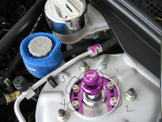

7gen03 is an unknown quantity at this point
I am not sure but from these pics it looks like the upper camber plates are useless> The bolts cant move either way and they shoul slide on the purple piece right? NUmbers 1-4 i circled so you can see what i mean the **** #5 looks nice but i am still wondering about the camber plates. Also the axis that the camber is adjusted on is no perpendicular with the the axis of the wheel meaning that if camber is adjusted it also screws up toe and caster.
Can you see the other hole in between the 2 at each side that you circled ? The holes cater for another mounting point for the camber adjustment bolts. So you can adjust the camber without any car frame mods.
ok i see now its hard to till from pics thanks just trying to clear up a few questions. BUt what about the way the camber gets adjusted Like i stated before. Is there a way to index the mount so the adjustment in camber is sisde to side instead of like it is in the pic almost front to back.
Perhaps the top mount has to be shifted so that the camber adjustment is more prominent side to side with a slight adjustment. You might want to ask Vnilman about this one.

So far no weird noises... Usually noises are an installation issue anyways
botlbobjr, yes you will have to drill the camber bolts a little bigger BUT you can always get the EP3 ones(since they use the same size) and just get custom spring rates(or just use theirs). That should work just fine..
7gen03, Glad you brought that up. I've been meaning to add it to my review... They meant to make it like that. Reason being when you autocross you usually want as much negative camber as well as POSITIVE CASTER. The way the plates are positioned you get two in one basically. If you want proof here it is..
"If you are a competition driver who frequently runs autocross, track or road race events, you'll typically want the maximum negative camber, maximum positive caster and most aggressive toe settings available from the car and permitted by the competition rules. If the rules permit, aftermarket camber plates and caster adjustments are good investments."
taken from http://www.tirerack.com/tires/tirete...eral/align.jsp
I'll go further in depth later...
