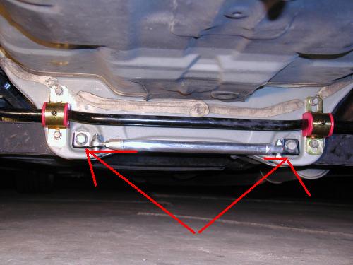

I have the DC5 Spoon bar on my car.
Old Jul 8, 2003
Green Civic's Avatar
Posts: 2,464
From: Luling, Louisiana
Nice pic. About how much did you pay for that? Any hard parts in the install? Thanx.

Boilermaker1's Avatar
Jap-Euro Fusion
Posts: 13,151
From: Washington DC
Rep Power: 424
Ok... the 2 bolts there are the ones that hold your lower suspension arms to the car. You simply remove them, put the Spoon endlinks on, bolt it all back together and using the supplied hardware, attach the bar between the endlinks. Done, end of story.
The only Lower Rear bar you need to drill for is the Neuspeed one.
You guys probably read Grey's DIY and he had to drill because he's got an 01 LX that did not have a sway bar from the factory.
