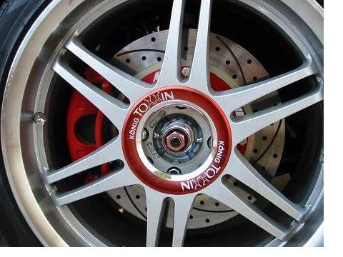

My AEM Rotor Brake Kit is pretty good for stopping my car. as for dust wise, i'm not sure, i know that the wilwood brake kit gives you lots brake dust...but as for the power our engine is producing, stock rotor is good enough, unless of course u do a swap or turbocharged
