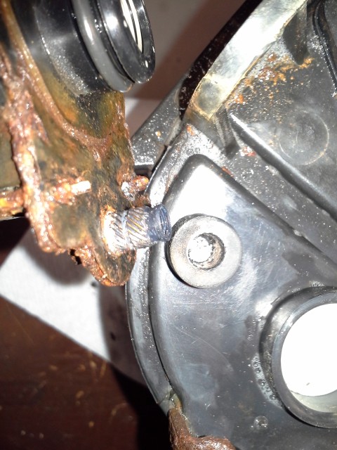

The car sounds bad at the wheels and shakes horribly at 55mph. I'm working on the brakes, which were terrible (original rotors! and in update New York? huh?!!) and hoping that will quiet the wheel. All wheel bearings feel ok to me, but I won't know until it's back on the road.
The passenger side sway bar link was broken. I assume replacing that will get rid of the shakes.

Thanks for all the advice.
I replaced the front pads, rotors, hardware and lubed the slides.
The rear drums and shoes were in acceptable condition and should last several more years. But I cleaned them up, replaced hardware, lightly ground the contact points smooth and lubed them. I also chipped away all the chunky rust from the outside of the drums.
I replaced the broken swaybar link, and then tugged hard on the other side and could feel a lot of movement. So I replaced that too. I like how the replacements have grease ports.
I ran out of time this evening but plan to get the wheels back on tomorrow for a test drive. Kind of excited. I hope she's smooth and quiet.

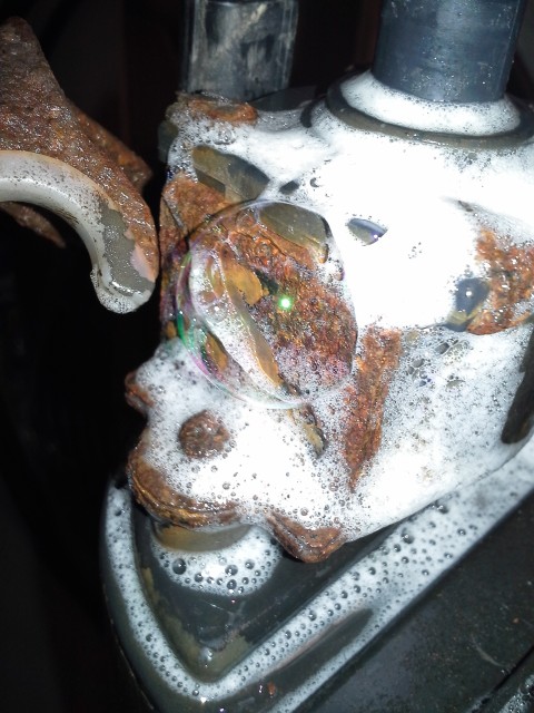

My test drive after my repairs ~5 days ago was pretty bad. It was disappointing how much noise I was hearing, all seemingly from the wheels. Did my improvements to the brakes and sway bar links do nothing?
When I was putting the rear tires back on I had noticed more than just low tread. I noticed areas of bald, and not around the entire tire but just islands.. I swore I could actually see bumps it in the profile.
I drove it to a gingerly drove it to the tire place.
After the new tires and all wheels balancing, holy cow! It's 10x quieter! It just entered the sell-able zone.
The only noise I sense now is from the from suspension/linkages. When I hit small bumps I hear movement. I'm thinking it might be a ball joint or tie rod end.
I had a neighbor of mine drive it who has restored cars. He didn't sense the problem. I was surprised. I was in the passenger seat and didn't feel it at all like when I drive. Maybe the extra weight in the car hides the problem?
I drove the car to work today and I felt the problem dozens of times.
I'll jack up each side and feel for play with the wheels on.
Isn't it like left and right play means on thing and up and down play means something else?

P1457 - EVAP Emission Control System Leak Detected (Control Canister System)
Several days ago I reset the code. I cleaned the gas fill tube end with some super fine grit wet sand paper, and cleaned the seal on the cap. Neither looked dirty. Today the light came back with the same code. I've had like 3 cars in the past that had this and never was able to fix them. Everyone always says it's the gas cap and it never seems to be.
I was always told a smoke test is the way to find the leak. Is this the way? Any alternative? I don't suppose there is a common cause for this on a 2005 Civic?
Old Aug 25, 2015
Re: Inherited 2005 EX Special Edition. Preparing to sell.
It's not the gas cap, it's not the gas tank. It's in the canister system.
Search this site for P1457, I've made many posts with pics of a common failure (CVS rusted out)

The problem does indeed appear to be the CVS rusted out.
Following several of your P1457 posts, I soaped it up gave it mouth to mouth. Bubbles!
I removed the canister to get to the screws. The screws required vice-grips and the screw inserts turned out instead of the screws.
So I'll probably use the right sized self-tapping screws for the new one.

Old Aug 27, 2015
At the point I found the inserts are gonna come out, I write the estimate to include a new charcoal canister.
Uhhhh I wouldn't use self tappers, you'll run through the canister and create more leaks.
I'd tell you to strap the new valve in place with plastic zip-ties or something so its tube and O ring can't fall out of the hole.. Wouldn't be the first one driving around like that.

The "right sized self-tapping screws" would use the holes the screw inserts left behind and would go no deeper. I could put a dab of sealant in the hole before the screw. It would be fine.
Alternatively I might clean up the bad CVS and use some sealant on it, then just epoxy it back in place.
