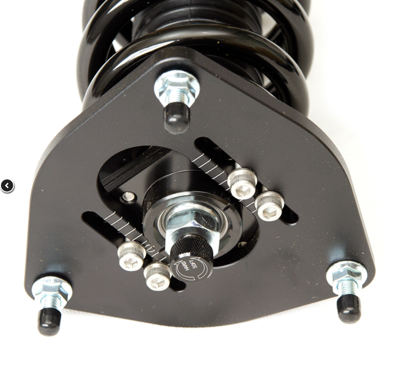

hmmmm interesting, so the website says that it has front and rear adjustable camber but i agree that the images dont show that?? and you reckon wait until i go to a track day before upgrading the sway bar?

Here's your front camber adjustment pictured on that site
Rear is done by an adjustable upper control arm. It says "rear camber plate (if applicable)". Not applicable in the case of the ES1
ah okay so it does have adjustable camber? or would i have to buy an adjustable rear upper control arm?

7th gen civics need an adjustable upper control arm, the top hats will not do it
rear is a multi-link trailing arm suspension type (which typically causes a higher negative camber gain throughout its course, making rear camber more problematic as you lower it).
